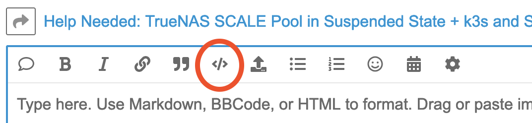

I had to take a break because you still did not put your output into code brackets. It takes away the motivation to help.
Sorry I don’t understand by “code brackets”

‘code brackets’ means to use Preformatted Text. </> on the toolbar, Ctrl+e
Fair enough. That is the </> button.

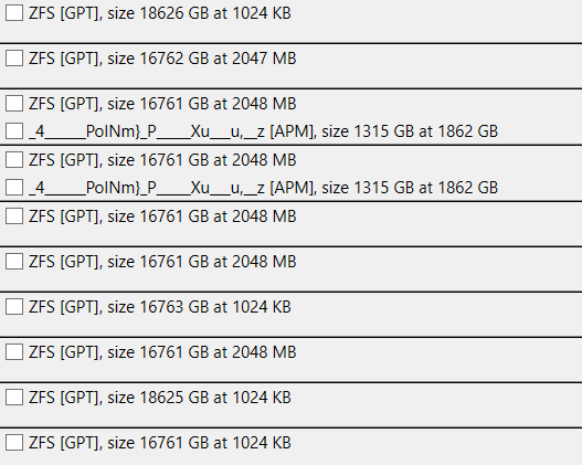

Scan is still going taking awhile notice this in the zfs structure. Is this normal?
Let us know when the scan is done. No clue what is normal looking for Klennet.
