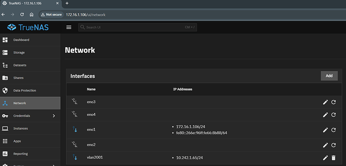

So I’m trying to install traefik on dockge. I created a per-app ip address and assigned it to dockge, and that works well.

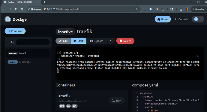

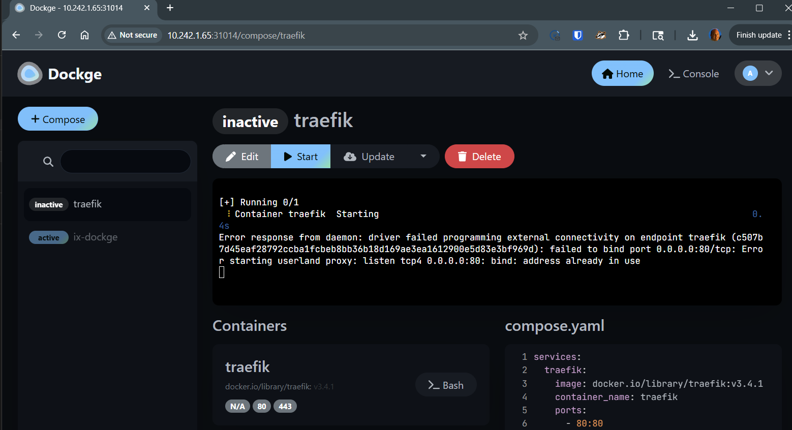

But when I try to start traefik, it binds to 0.0.0.0 and detects a conflict with port 80. How do I need to configure dockge to not let traefik use 0.0.0.0, but use it’s assigned address of 10.242.1.65?

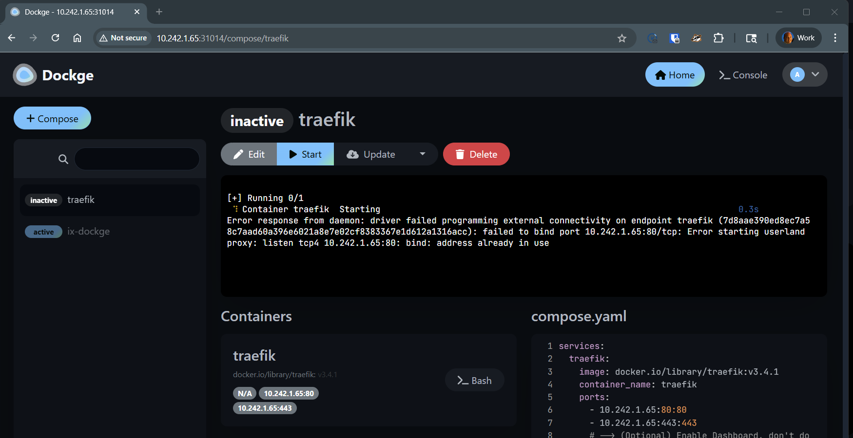

Instead of using
port:port binding
use
ip:port:port binding in your Traefik compose.

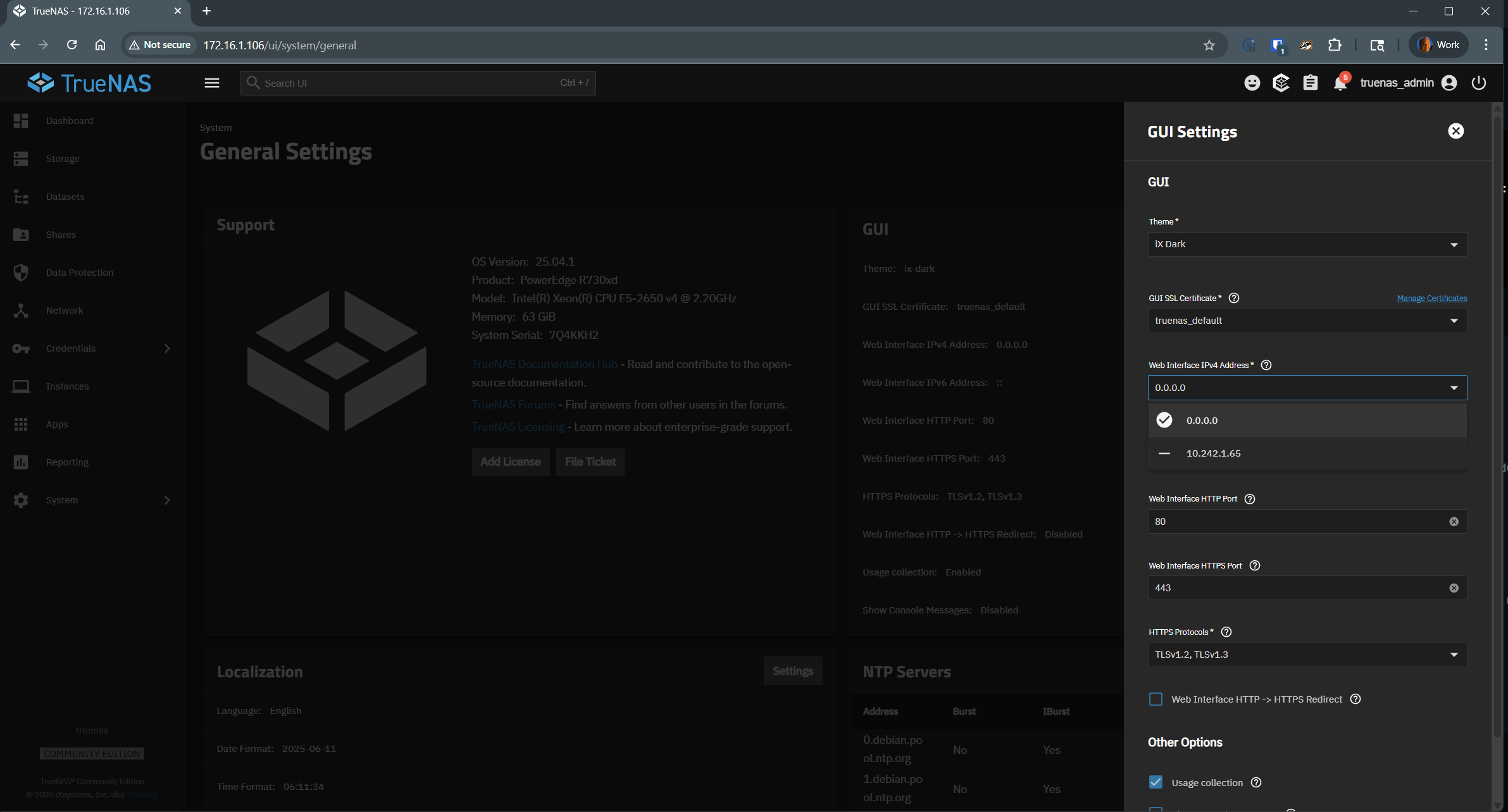

The reason I wanted it on it’s own address, is so I don’t keep running into issues with the host. The only thing on 10.242.1.65 is Dockge (on port 31014) and Traefik. The only thing running port 80 is the TrueNas portal, and I can’t choose 172.16.1.106 for the GUI settings, yet I can access it that way.
But I still get this:
But Traefik isn’t on that IP, unless you specifically tell it to be–Stux explained how.
