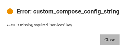

But the reason I’m coming back to this thread is to report that TrueNAS 25.10 partially breaks this now:
The workaround is to prepend services: {} at the top above your include:
EDIT: Bug has been filed: Jira
