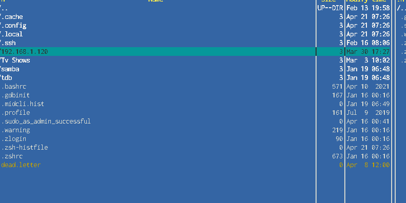

I looked at MC
I see this as a file structure and i see that under /root i have 192.168.1.120 (which is the ip address of my second server) what is it doing here?
If i drill down on this address i get /Tv Shows (which is one of my datasets)
yet /TV Shows is also a folder of /root
Furthermore i do see /mnt and all my pool
IYHO
can i delete there 2 subfolders?
i will need to further learn how to navigate MC to see the disk view

No idea. You put it there somehow.
Yes, if you don’t need them. Or move them to wherever they belong on your pool.

To be clear: You are fine with permanently deleting the 56 GiB worth of files from the /root/ folder?
Yeah, 56 GB is not a trivial amount of stuff. I’d be weary of nuking it unceremoniously.

I played with MC and trough trial and error I manage to delete folder /192.168.1.120 and folder /Tv Shows and al the content.
However i did not learn how to access the content of a specific disk ā€œSDAā€
This did free up some space. however i still show 63gb in SD3 which is part of the boot-pool SDA

From the Screenshots I see you have data directly on the boot pool, meaning ./: you have to delete anything that you are sure is a TV show or similar.
You will need to mount SDA3 to a folder to be able to see what it contains using MC.
sudo mount /dev/sda3 /media Should work for you, in Truenas the media folder is normally empty. You might check first though.
No, it wouldn’t. sda3 is part of the boot pool; it’s already mounted.
