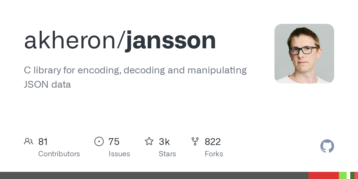

These days when I’m writing userspace code in C and need to parse strings for structured data, I use libjansson and just require JSON. It’s MIT-licensed and API is simple. Very fast to push out boiler-plate code (that’s how I wrote up the JSON input / output for nfs4-xdr-tools).
FWIW, it’s used by the samba project for their JSON support.

*blink-blink* whoa?! That’s the bug I needed to work on! lol It’s like you just knew! …I was actually just toying with a “language independent tokenizer thing” (obviously not a full parser or anything so we’re not talking about arrays or anything) but I was playing around with parsing (tokenizing) the different styles (no spaces, 15 spaces, equal sign / colon separator, terminator, etc.) and JSON was giving me the most trouble at the moment. Awesome response! :smiley:
My code will probably never see the light of day (why would my stuff be good enough for anything but being playing with), but I will defiantly check it out. Have you looked at the libucl library?
