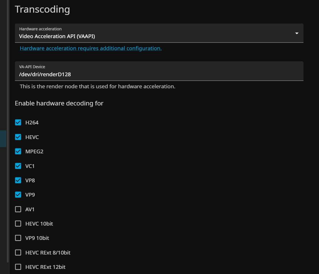

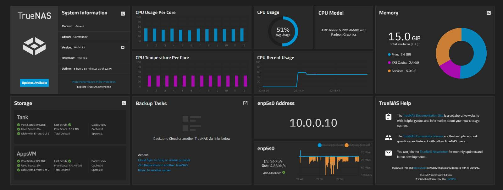

Hey, I had some time to test this yesterday.
Good news this is working but you will need to use all 6 CPU cores. Otherwise you still get a little bit of shuttering. CPU utilization goes up to 50% and temp increase to 50 degree.
I have tested this with Ballerina.2025.2160p.4K.WEB.x265.10bit.AAC5.1-[YTS.MX]
MKV file 5.5 GB. From the log “FFmpeg.Transcode” log I understand that transcoding is happening of the 4K HEVC Dolby Vision Profile 8.1 (HDR10) file. I am new to this but it seems to be using the codec HEVC to my 2K monitor. According to AI the difference between 2K and 4K monitor should not be problem? Dont mind the uptime of the screenshot I am installing some smart switches atm.
Why not iGPU for transcode? Curious to see what kind of quality you would get
I think this is with the iGPU, I selected the following. When I am home again I can verify also via the CLI and let you known. When I forgot to select GPU configuration> passthrough available (non nivdia) GPUs. it was not working and had a critical error and shuttering. So I guess that would indicate that transcoding via iGPU is active? I followed the youtube guide from Serverathome for the installation. The config/cache dataset is on the nvme drive. I kept most default settings.
ah ok, yeah should be it then. i guess i expected almost no cpu usage, but that my lack of knowledge i guess. since subs and sound is still on cpu side
