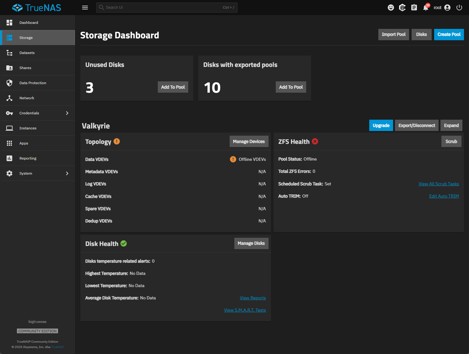

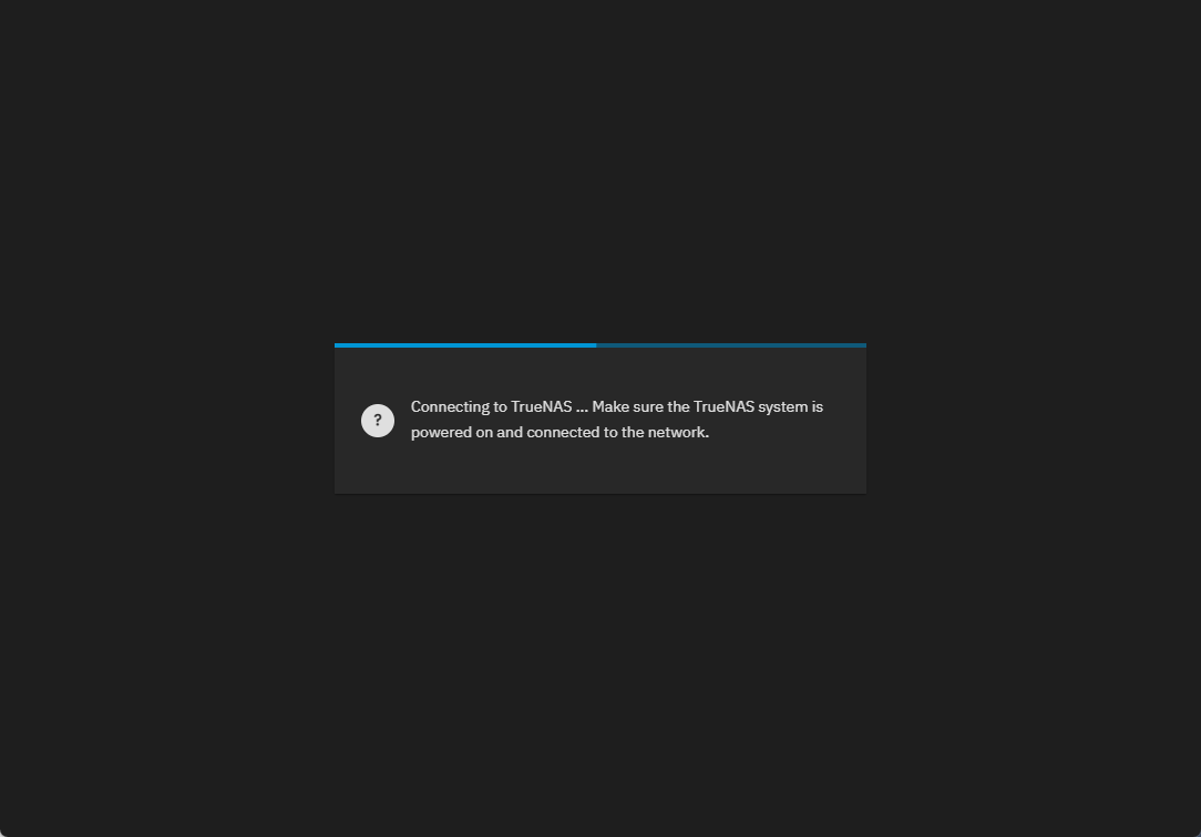

Gone for the weekend, returned to pool missing, possible drive failure, no idea what to do

So, I’m not touching anything but it doesn’t appear that I have the pools imported yet. Assuming that there is still more to do?

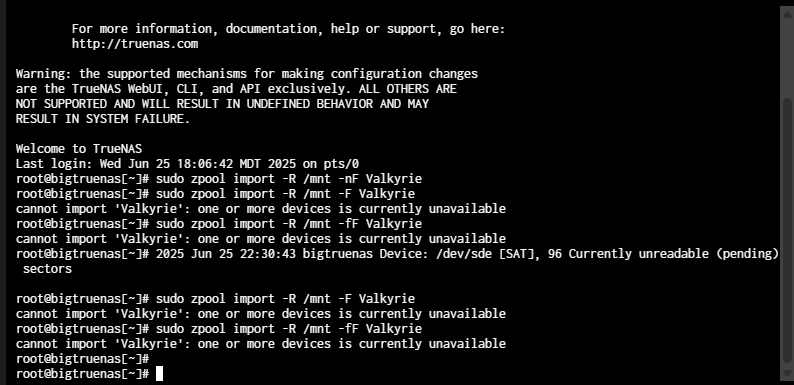

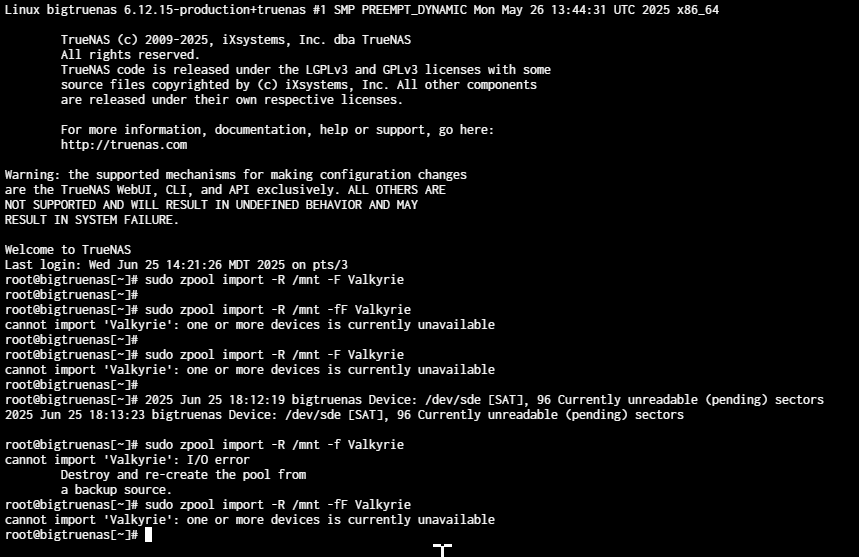

So - in the first instance you ran zpool import -nF -R /mnt Valkyrie and it seemed to suggest that it should import OK, and then you ran zpool import -F -R /mnt Valkyrie and it appeared actually to have imported.
Again when you ran zpool import -nF -R /mnt Valkyrie it seemed to suggest that it should import, and then you ran zpool import -F -R /mnt Valkyrie and it failed to import and said one or more devices were unavailable.
If you can put your hardware back to the state it was in in the first attempt, maybe it will still import.
If you have already done this and it doesn’t now import, then the situation appears to have got significantly worse.
It is my belief that with changing hardware and reboots we need to re-establish whether the pool can be imported or not with “-F” and if it can then we need to import it and see what the situation is.

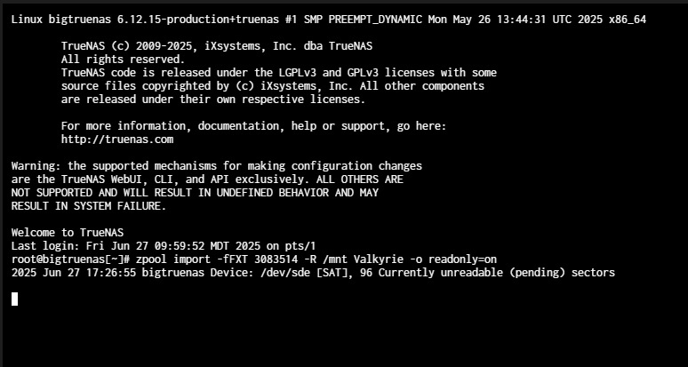

Yes. Oddly enough your dbgmsg log there does not seem to show actual errors after the import attempt at using uberblock with txg=3083521 which is where I expect it’s going in.
I would suggest that you reboot your system, which will ensure the pool isn’t mounted - check the webUI and zpool status -v from the command line to be sure - and then run:
zpool import -fF -R /mnt Valkyrie -o readonly=on
Grab the output of the last 200 lines of dbgmsg as before.
If the import returns without errors, then your data should be visible - but be read-only - on the /mnt/Valkyrie path. If that’s the case, check that any recently added files seem to be OK. Exporting the pool (zpool export Valkyrie) and then re-running the command without -o readonly=on will commit those changes.
If the import returns errors, we have more work to do.

Okay, so it is starting at 3083521 as expected and attempts a light rewind.
We can try again with zpool import -fFX -R /mnt Valkyrie -o readonly=on to tell it to take a more aggressive rollback posture, or jump straight to 3083514 if that drive is connected with zpool import -fFXT 3083514 -R /mnt Valkyrie -o readonly=on
So I’m not sure which to do. Is one better than the other, or should I just try the first suggestion and then the second? I’m feeling a little skittish.
They are both leveraging the same level of aggressiveness; -T just tells it to not bother starting any higher up, and to begin with a group no higher than 3083514.
I assume you have the “failing” drive still connected?
Once this happens, try to pull another set of dbgmsg logs for me please.
Thank you for explaining. Very much appreciated. Yes, the failing drive is still connected. So I ran that and I hear the hard drives accessing a bit and then silence. and this is still what I’m seeing:
I walked away and came back to the login screen so I don’t know what happened.
Here’s the dbgmsg log.

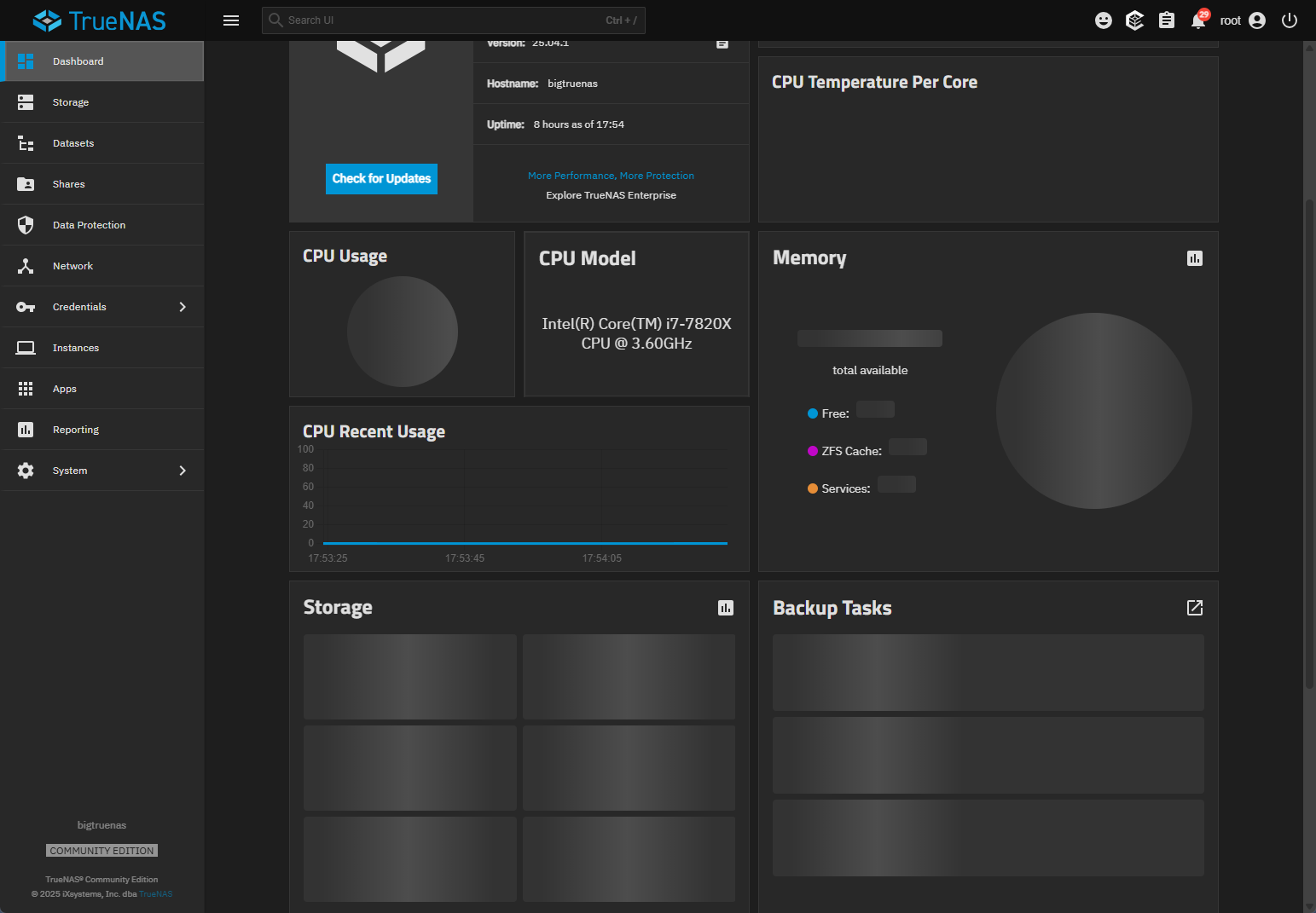

Also when I look at the Dashboard, nothing loads, just looks like it’s busy and not loading anything.
@HoneyBadger

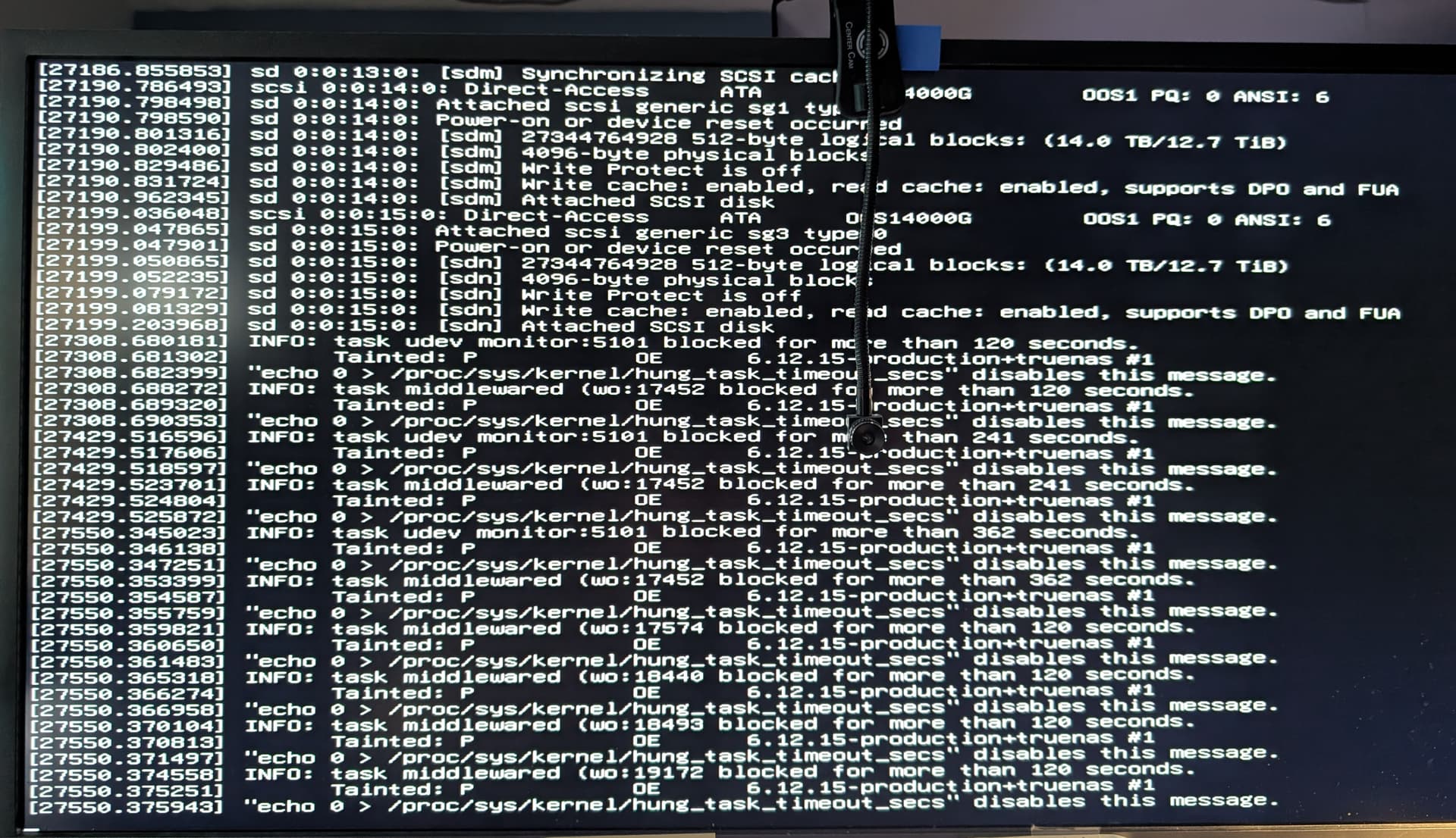

I went away from the server for a while. When I came back all I saw was this screen.
I took a look at the actual connected monitor screen and this is what I see
Not sure what to do now. Do I just wait or is something not working?
The console looks like the system rebooted at some point during the import, and it’s now hung up and blocking progress because of a disk timeout. We may need to disconnect the “failing” drive if it’s actually so far gone that we’re throwing ATA errors because of it.
Your dbgmsg is also full of data errors, which is a challenge because if both the failed/failing drives are pulled, there’s no parity to rebuild from. Do you have a third new drive you were planning to replace either of these two with?
I have two new drives that I was planning to use and another spare on the way. If it rebooted, then it was when I was away and it did it on its own. I didn’t restart it. Those two new drives are connected to the system but I haven’t done anything else with them.
Should I shutdown, disconnect the failed drive and restart? Or what’s the best next step?
Are you doing these import attempts using the TrueNAS shell? It kind of looks like it from the screenshots you posted.
If so, you need to use tmux since the import will take longer than the GUI session will last. Using ssh instead of the GUI shell is also an option.
Yes, I didn’t know not to do that. It never occurred to me to not use that. Using SSH now instead.

Then I ran: zpool import -fFX -R /mnt Valkyrie -o readonly=on and I hear the drives doing things and no command prompt yet, so it’s doing something it seems.
I did run in a TMUX and that worked or at least it didn’t just hang like the last time. This is what I got finally.
mike@bigtruenas:~$ sudo zpool import -fFX -R /mnt Valkyrie -o readonly=on
cannot import 'Valkyrie': one or more devices is currently unavailable
