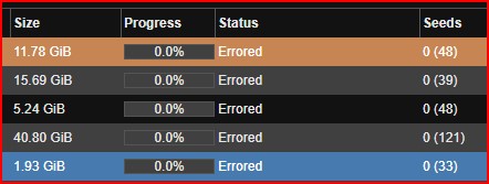

thanks for guide, i got the app working and tested for the ipleak, it is running with Wireguard and AirVPN. for some reason i am not able to download any files. all my downloads are failing with Status ā€œErroredā€.
config file used:
services:
  gluetun:
    cap_add:
      - NET_ADMIN
    container_name: gluetun
    devices:
      - /dev/net/tun:/dev/net/tun
    environment:
      - TZ=America/Chicago
      - VPN_SERVICE_PROVIDER=custom
      - VPN_TYPE=wireguard
      - WIREGUARD_ENDPOINT_IP=redacted
      - WIREGUARD_ENDPOINT_PORT=51820
      - WIREGUARD_PUBLIC_KEY=redacted
      - WIREGUARD_PRIVATE_KEY=redacted
      - WIREGUARD_PRESHARED_KEY=redacted
      - WIREGUARD_ADDRESSES=redacted
      - FIREWALL_VPN_INPUT_PORTS=6881
      - SERVER_COUNTRIES= #optional
      - DNS_ADDRESS= redacted
    image: qmcgaw/gluetun:latest
    ports:
      - 8888:8888/tcp # HTTP proxy
      - 8388:8388/tcp # Shadowsocks
      - 8388:8388/udp # Shadowsocks
      - 8080:8080 #qbittorrent
      - 6881:6881 #qbittorrent
      - 6881:6881/udp #qbittorrent
    restart: unless-stopped
  qbittorrent:
    container_name: qbittorrent2
    depends_on:
      - gluetun
    environment:
      - PUID=568
      - PGID=568
      - WEBUI_PORT=8080
    image: linuxserver/qbittorrent:latest
    network_mode: service:gluetun
    volumes:
      - /mnt/redacted:/config
      - /media:/media
any suggestion to fix this is appreciated.
Thank you
this is resolved, turns out to be an issue with the volume path for /media
