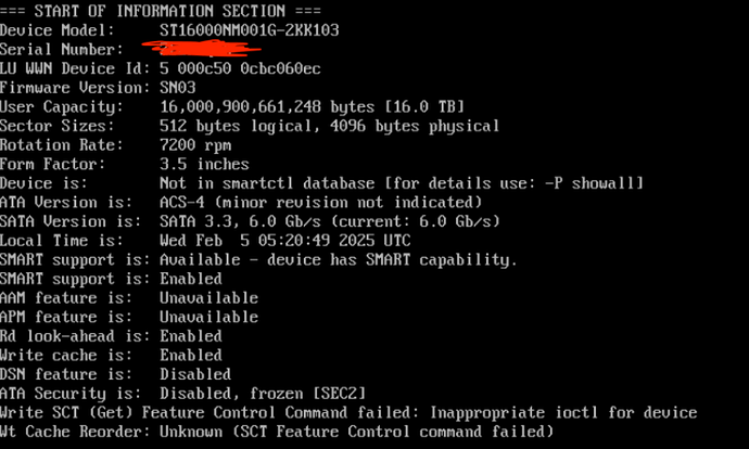

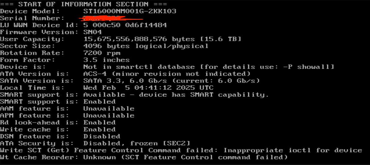

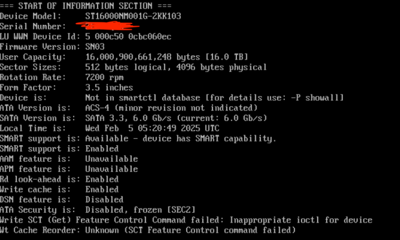

I do for sure my friend. I’ve been checking that disk twice a day and the space reported is same. As you were not available, @Johnny_Fartpants stepped in for help and also asked me for the smartctl which i provided:
Seagate EXOS 16TB (Factory firmware SN03 and factory defaults sector size 512e):
Seagate EXOS 16TB (Firmware update to SN04 from SN03 using SeaChest Bootable and sector size changed to 4096):

The disks were new (unallocated partition) and i did firmware upgrade+change sector size to 4K and i’ve lost like 500GB approx of usable space

Can you post your smartctl, please?
