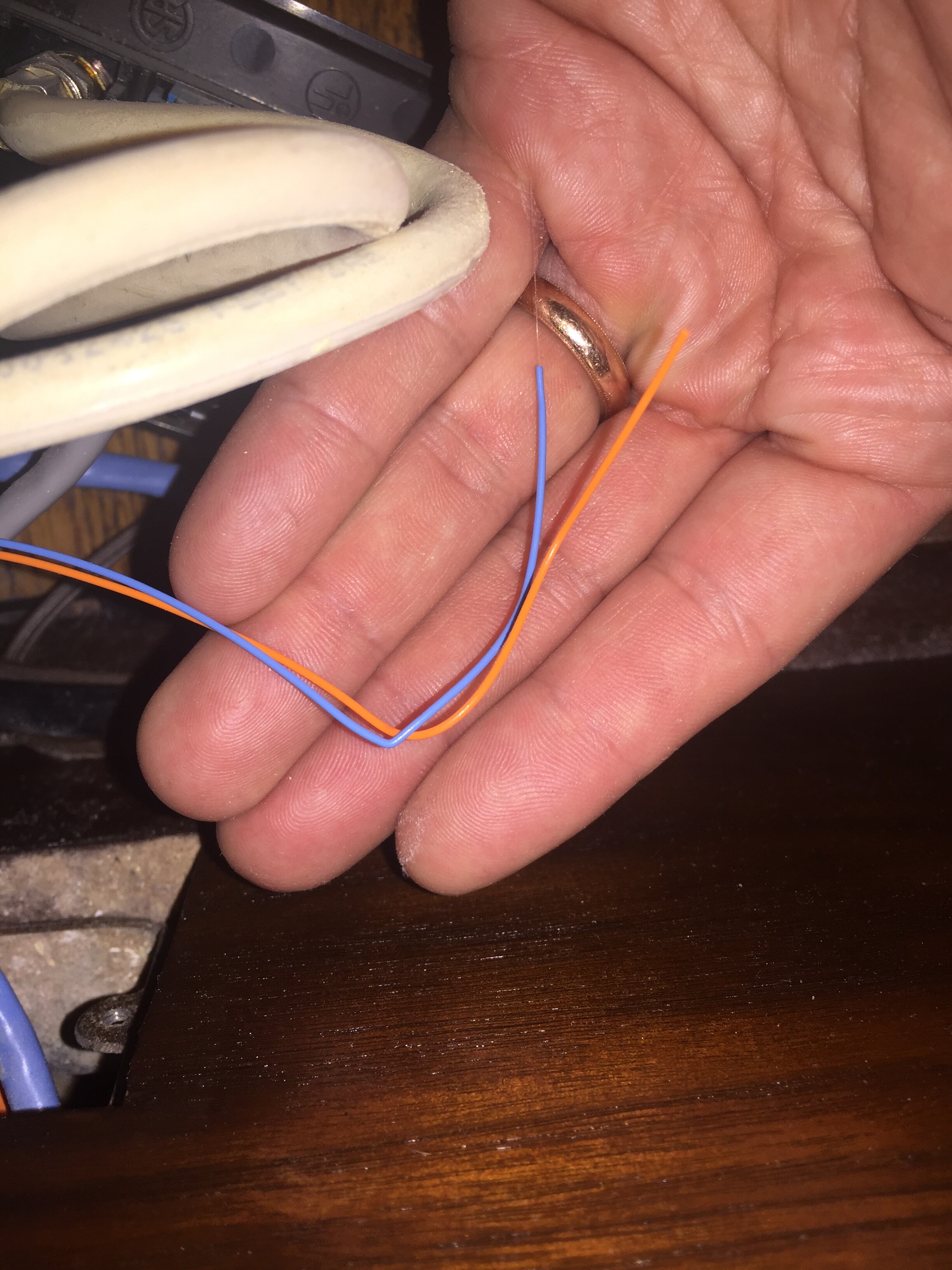

Ok, so someone who demonstrated rank incompetence re fiber should be invited back into the house after he smushed every fiber combination he got his hands on?
All my structured wiring is embedded in foam-filled walls. There are no do overs, I got ONE chance per drop to make a working fix, no more. One of my office drops was too short and could no longer be terminated without opening the wall, adding a splice / patch and then closing up the wall again.
I am a glutton for punishment at times but there is a limit.

They break something, they pay for it; if they are not able to fix it themselves, they pay for someone to fix it… or, they rembourse you.
…and now I think you see why running the cabling in conduit might have been a good idea. But I suppose we’re getting rather far afield of OP’s question.

lol. In Europe, maybe. Loser pays court cases and all that.
I am very happy with said electrician re his high and low voltage electrical work and at the same time will never endorse him for anything related to fiber.
Pick your battles.
