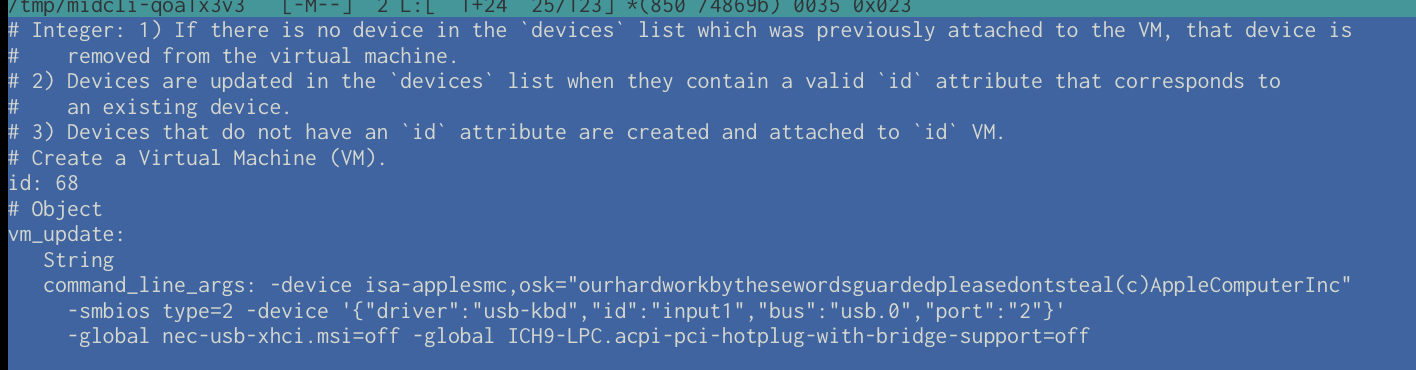

Can this be done for the comand line arguments as well?
-device isa-applesmc,osk="ourhardworkbythesewordsguardedpleasedontsteal(c)AppleComputerInc"
-smbios type=2 -device '{"driver":"usb-kbd","id":"input1","bus":"usb.0","port":"2"}'
-global nec-usb-xhci.msi=off -global ICH9-LPC.acpi-pci-hotplug-with-bridge-support=off
This didnt work
sudo cli -c “vm update id=59 comand_line_args: -device isa-applesmc,osk=“ourhardworkbythesewordsguardedpleasedontsteal(c)AppleComputerInc” -smbios type=2 -device ‘{“driver”:“usb-kbd”,“id”:“input1”,“bus”:“usb.0”,“port”:“2”}’ -global nec-usb-xhci.msi=off -global ICH9-LPC.acpi-pci-hotplug-with-bridge-support=off”
I have to say, I followed the guide and it worked first try!
I have this in mine:
machine_type: q35
arch_type: x86_64
Both work fine, no errors, works. You probably forgot, again, the leading spaces? Note there are exactly 2 leading spaces before each of those lines.

Okay, so I am having an issue with the CLI. It is not keeping the CLA, arch, and VM types uncommented. I save the file and then open it again to verify that it took the changes, but those changes are still uncommented with a #; I can’t seem to get rid of the #
Can I even remove it?
Others have had success with TNS and MacOS what am I doing wrong any ideas?
It is supposed to be uncommented. When you add stuff or make changes you have to uncomment it before you save. Then when you exit and save or whatever and run it, it should comment those lines, but your changes will show up. If your changes show up but are commented that is good. If you have to change an existing commented line, you have to uncomment it before saving, otherwise your changes won’t apply.

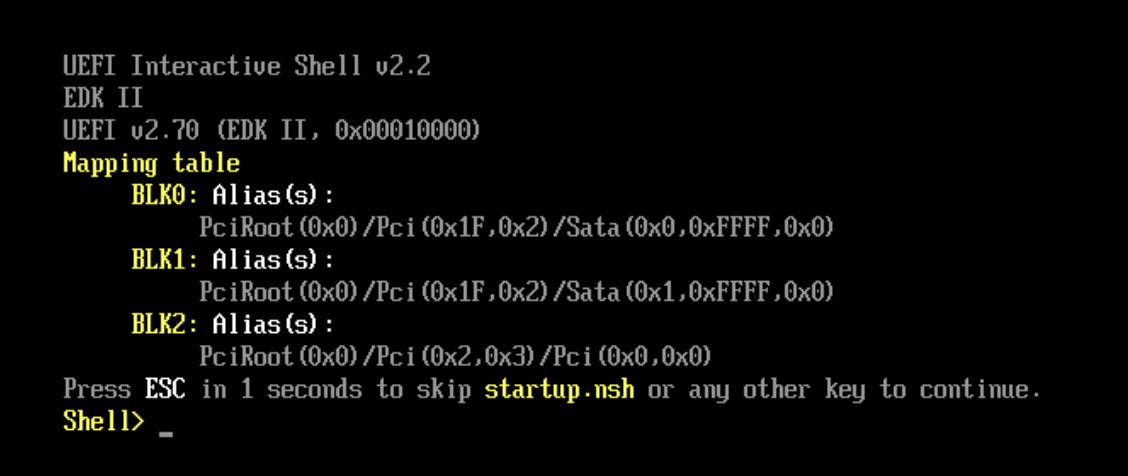

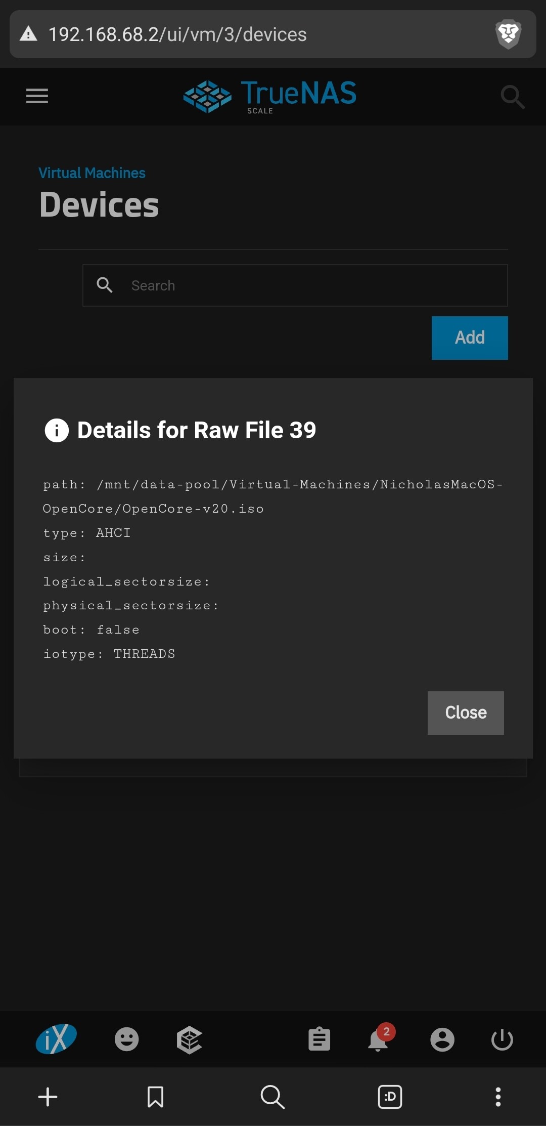

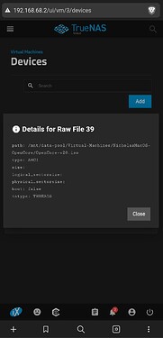

I am not getting an error when trying to save or start the VM I am getting stuck at the UEFI Screen with no FS0 to select.
I try hitting exit and go to the bios device to choose the opencore v21 ISO but I don’t see it.
Pretty sure the issue is what I told you in DMs.
Did you remove the Raw File device with the Opencore iso? If so you need to add it back.

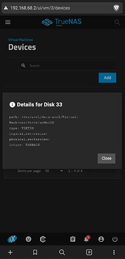

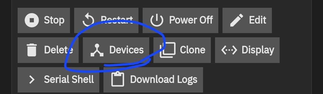

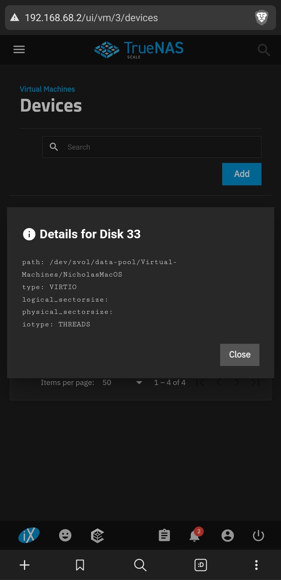

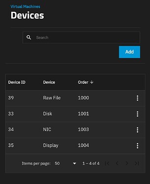

My working setup with the Raw File for Opencore and the disk for the install:
So, you need 2 storage devices like this:

I have two isos mounted as raw files now
First is Open Core
Second is Sequoia
I am trying to boot off of Sequoia and its thinking
As an ISO? What guide are you following?
