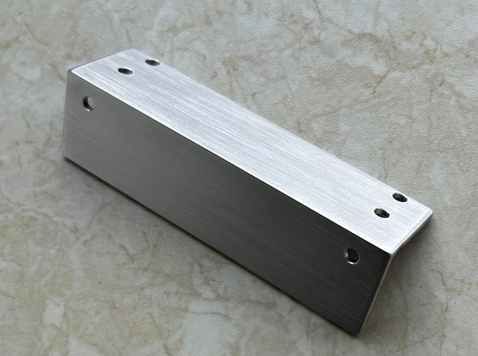

Since this would also require some modding as well, I build myself a adapter from right angle aluminum profile I had lying around:
This is a third-party adapter.

Yeah, that’s pretty similar to what I used. It was very close to what I needed, only a bit of metal work to make it fit. How is your build coming along?
