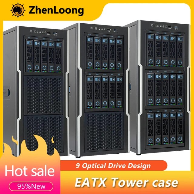

The old 5x front hotswappable 3.5” drives in in 3 5.25” drive bay trick
https://www.aliexpress.com/item/1005006565908543.html
My backup server actually uses one of these.

Keep in mind, most of the 5x3 hot-swap arrays our there also specialize in baking HDDs to a creamy consistency. There is simply too little room between HDDs and too little resultant airflow with the included fans to not unleash a little heat goblin once a resilver or scrub strikes. I remember my HDDs clocking in at 45*C+.
Just nope.
You could pupulate just 2 or 3 of the five slots.
IcyDock ones are (were?) pretty good. They have an ntegrated fan and iirc temperature controller, or at least fan speed selector.
I’ve got iStarUSA 5-in-3 from many years ago, and the 80mm fan at the back isn’t up to the job of pulling air over the drives. Because they need room for connectors (which are directly connected to the backplane), that’s the largest fan that these units can hold.
Somebody needs to design one of these units with a 120mm fan right behind the drives, and a void behind that where only about 10% of the space is blocked for the connectors, with cables from the connectors to the backplane that route on either side of the fans.
And, the fan needs to be connected to power via a standard 3-pin fan connector, not somethng oddball, so the user can replace it easily.
iirc, some ouble 5.25’’ have a 120mm and some single 5.25’’ have double 80mm fans.

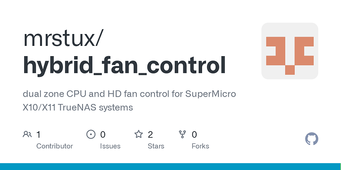

I have t looked into it. But if your board is Supermicro x10 or newer you can probably run a custom fan controller script.
Like this:
Ohh, that looks really nice. I think I would prefer that. I want to be able to stick 16 drives into it and will need good airflow.
The fan controller script from @Stux is great. My fans loaf along at less than 50% with the HDDs at 30C and below, ie room temperature plus 5C.
It’s a great script and now my NAS is quieter than the pi cluster enclosure fans.
