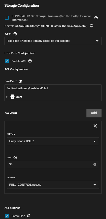

That step is talking about adding an ACL entry in the Nextcloud storage configuration when you add the host path. Click Host Path > Enable ACL > enter the host path > Click ADD for an ACL Entry and enter UID 33 > add the Force flag if the dataset contains existing data. It should look like this:
