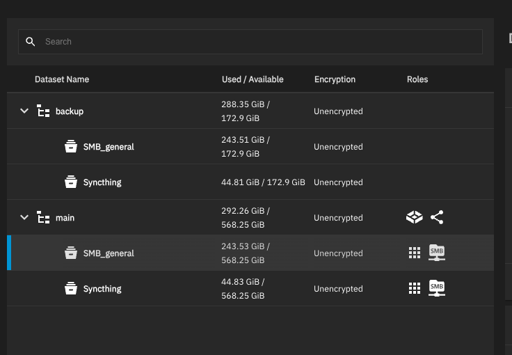

Hello, there are a few things that I’m actually confused about and feel there are some inconsistencies with some terms in ZFS and terms in TrueNAS. I’m sorry if this feels pedantic, but I’d just like to make sure my understanding is correct.
When you first setup TrueNAS and create a “Pool”. You select Storage and then select the devices in storage to create vdev’s. This is where the pools live or rather by TrueNAS terms “Datasets”. These “Datasets” are actually Pools, correct? Please forgive me regarding my setup below this was my first TrueNAS configuration and I’m still learning.
Based on your question and my understanding of ZFS. Backup and main are both pools. SMB_general and Syncthing are both dataset’s and both root datasets. They have no children.
The way these are setup right now is that “main” is replicating to “backup”. You can see they share relatively the same size.

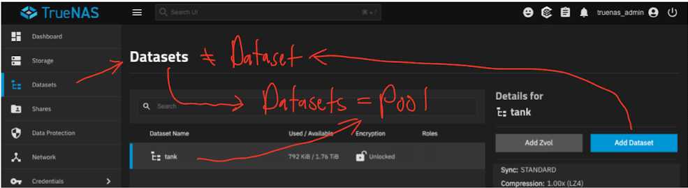

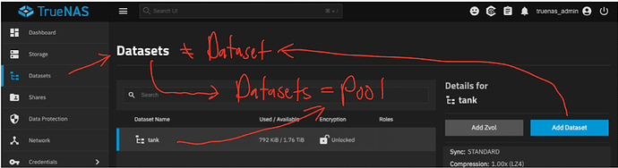

I’m talking about the menu selection Datasets, and not the “Add Dataset” button. I understand that a Dataset is for an SMB share or something that acts like a fileystem. The Datasets selection in the left menu is a Pool, right?
So, in this image below the Pool is called “Tank”?
This is why I think the original design for ZFS was a mistake.
That thing in your screenshot is the “root dataset”. The root dataset is still a dataset. It is also named the same as the pool itself.
EDIT: To better help understand. In the command-line, any commands that start with zfs deal with datasets (and zvols and snapshots). Any commands that start with zpool deal with pools (and vdevs).
In the GUI, you only deal with datasets under the “Datasets” section.

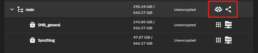

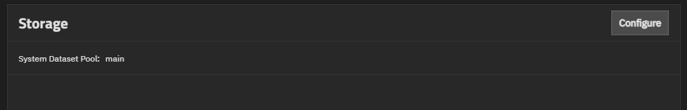

So, the below option is unique to TrueNAS and totally separate from the .system that is in the root dataset?
I’m sorry, but I’m a bit confused at what you’re talking about below.
Do you mean you cannot see the .system dataset in the GUI? I thought if you encrypt with either key/passphrase the dataset that is storing the TrueNAS specific System Dataset then you would need the key to unlock it and it won’t auto unlock?

It’s poor UI design.
All it does is confuse people. They see “System Dataset Pool”.
What it should read is:
main (contains hidden .system dataset, "System Dataset")
What do I know? I’m just an end-user.
You have pools. You have datasets. TrueNAS creates and uses a hidden dataset named .system, which it uses to house important system files, separate from the base OS. It can place this dataset (.system) under the boot-pool or any pool of your choice.
It calls this hidden dataset “System Dataset”.
For some reason, whichever pool has this hidden .system dataset, the UI refers to it as the “System Dataset Pool”. I think that’s silly and only confuses people…
Correct. There’s nothing special about it.
Using zfs in the command-line will show it and treat it like any typical dataset. The TrueNAS UI does not let you directly interact with it and hides it from being displayed. (Intentionally.)
If you encrypt the pool’s top-level root dataset, TrueNAS will not allow this to be passphrase-protected. This is because TrueNAS demands that the System Dataset (.system) is immediately available at boot.
If you use a key, that’s fine, since the key is stored on the unencrypted boot-pool, which allows the root dataset to be automatically unlocked, which also unlocks the .system dataset. (Whatever the root dataset has, the .system dataset inherits. You could override this with the command-line, bypassing the GUI, but it will most likely break your system.)
