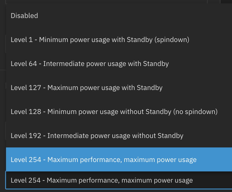

I changed Advanced Power Management to 254 from Disable. Maybe this will help
Disabled should work. If you can keep track of a few of the smart reports and track over time to see if and when they increment, that might help point to the source.
Disabled was the default. 12k Load Cycle Count is with “Disabled”
