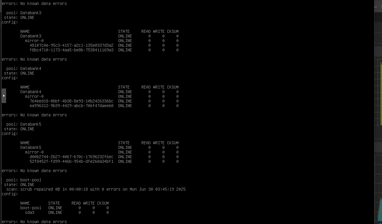

sudo zpool status -v

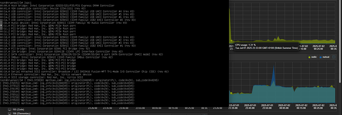

lspci

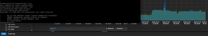

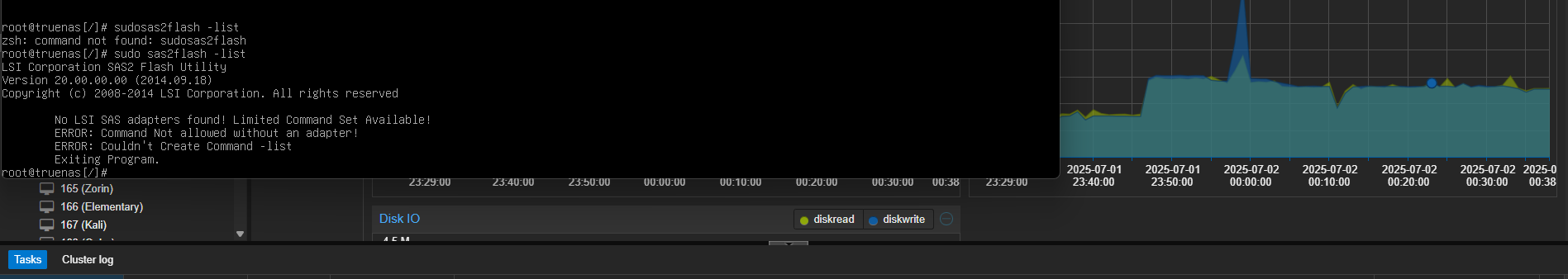

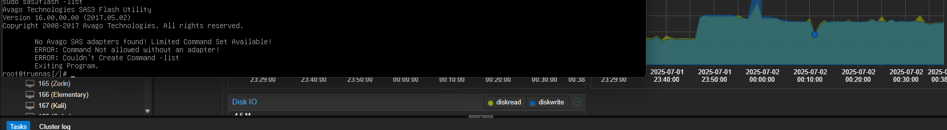

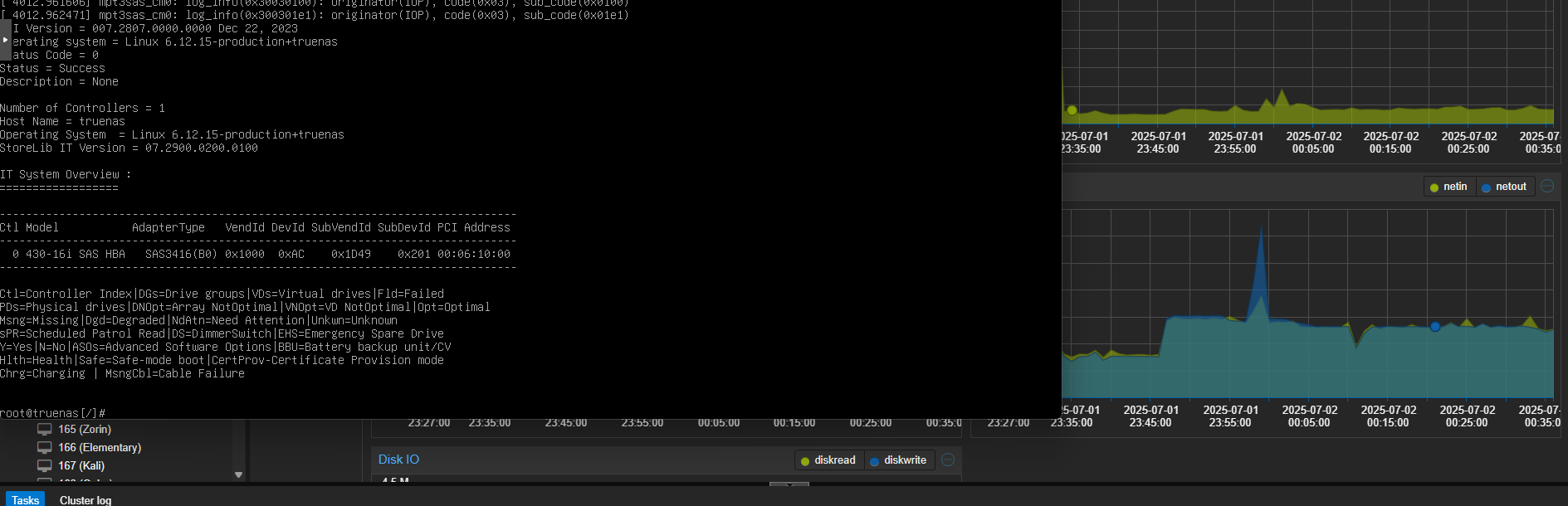

sudo sas2flash -list
sudo sas3flash -list

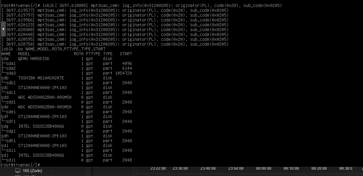

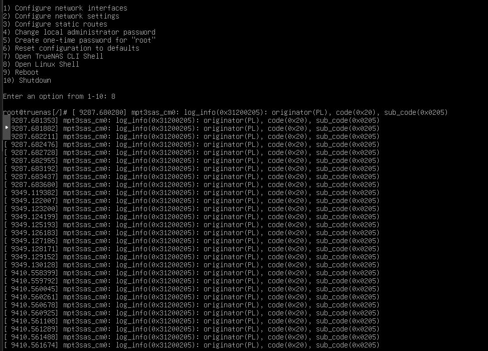

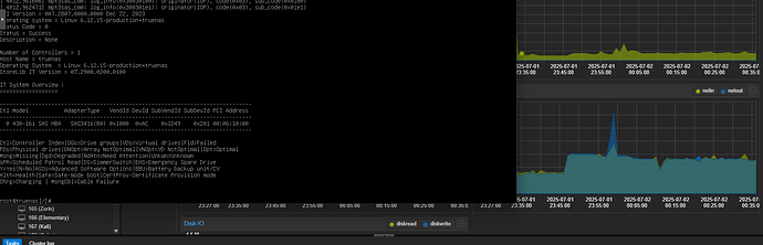

I have also just notice while i was trying to run these commands these erorr message kept come up

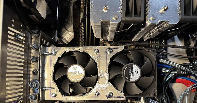

Ok thank you for that I am just in the process now of making a bracket to mount two small fans beside it as I don’t have a lot of space under between cards, I will post a picture once I am done
First and foremost I would like to say thank you for everyone’s help.

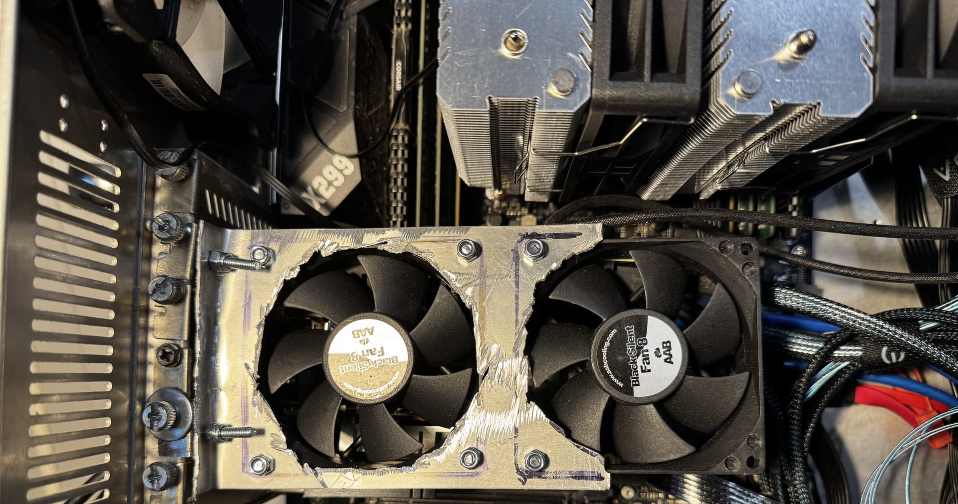

So what I have done is create a bracket to hold 2X 80mm fans to the side of my lsi 9400,10gb Nic card and 2.5 nic card to create a constant air flow directly to the cards. and I can now confirm that my previous fault which was one of my mirror raids had degraded, has now seemed to disappeared and fully functional again.
Please excuse the metal work I plan to re do it again once it had proven it would work.

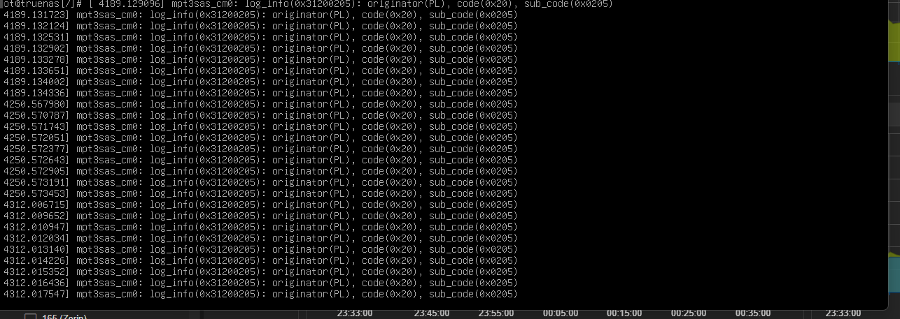

The only problem I have now is these messages keep repeating in truenas scale shell, does anyone know what could be causing this …?
error screen shot below
