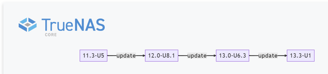

The TrueNAS documentation recommends this upgrade path:
13.3 Version Notes | TrueNAS Documentation Hub
and you have already partially done the process earlier by burning the .iso file to a memory stick, rebooting from that and installing onto your boot drive. Once that new installation starts up from the boot drive then re-import the config file and your pool should be accessible again.
