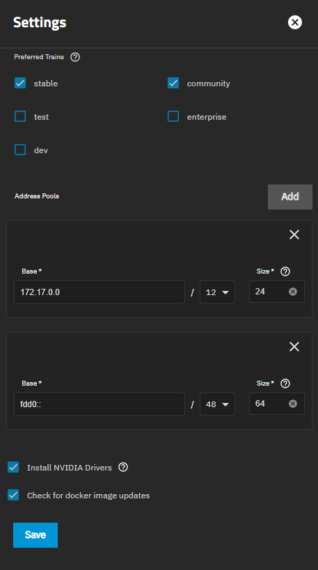

Can you please post a screenshot of Apps → Configuration → Settings?
As well as post the output of sudo ifconfig
That’s because of port forwarding. I suppose that the actual IP (visible inside the container) is different.
