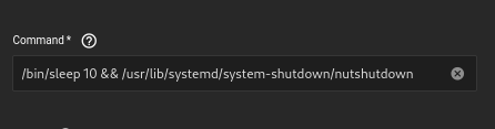

Great to hear! Would you be able to try a few further items? I’d do this myself but I deployed the system I was testing with to my brothers house this past weekend as an off-site backup. That makes it a little more difficult for me to play around.
Assuming you’re able and willing, I’ve been wondering if instead of calling the driver directly, we would deploy the Shutdown Script like we have been but with the sleep and the nutshutdown systemd hook script.
I think this should then work for the command: /bin/sleep 10 && /usr/lib/systemd/system-shutdown/nutshutdown
Should nutshutdown work with the sleep, that would be be a more robust work around. The Shutdown Script should not be necessary so there’s still a root cause to be found here.
that works as well
