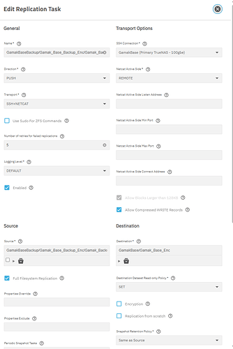

What is the configuration you use for the Replication Task to “send it back”? Is it tied to a Periodic Snapshot Task?
Here’s a screenshot of the replication task.
My goal is to get the data the same on both TrueNAS systems and then be able to send changes from the primary to the secondary on a scheduled basis. Ideally, both the primary and secondary will be encrypted. I’d like to get to the point that the primary can send a WOL packet tot eh secondary to wake it up and complete the backup/sync, however I am trying to get through one thing at a time.

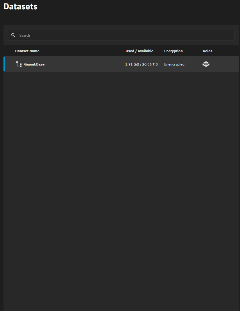

I added disks to the pool on the primary, and felt it would be better to delete the pool and recreate it to get past the issue of the extended pool having less space than when created from scratch.
Now I am at the point of trying to get the data back to the primary from the secondary. Hopefully that helps to explain the situation.
Thanks

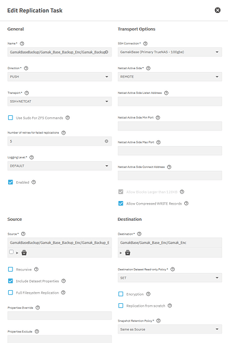

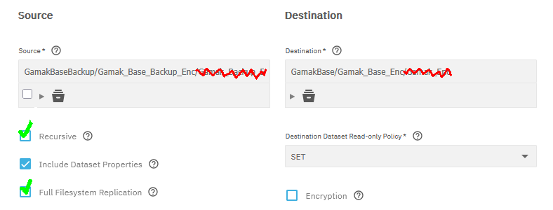

No reason to leave “Recursive” and “Full Filesystem Replication” unchecked.
You want everything and you want to invoke a raw stream.
Does SCALE (“CE”) allow you to manually type inside the text fields for the locations?
This should be your source:
GamakBaseBackup/GamakBaseBackupEnc
This should be your target:
GamakBase/Gamak_Base_Enc
The child dataset Gamak_Base_Enc should not exist on the target pool. The replication will create it for you. If it already exists (and there’s no important data on it), then delete it. It’s unclear from your screenshot if it exists or if you manually typed in the target.
You want everything, including children, from GamakBaseBackupEnc? Correct?
Gamak_Base_Enc is to be an exact replica of GamakBaseBackupEnc on the new primary pool? Including all of its children?
If this doesn’t work, then you might have to resort to the command-line for this one-time migration.

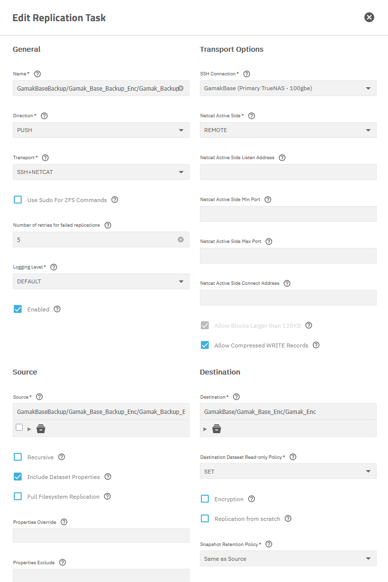

I setup a new replication task with the options you list. I am still getting the no matching snapshot message.
[2025/05/21 07:45:05] INFO     [Thread-11] [zettarepl.paramiko.replication_task__task_2] Connected (version 2.0, client OpenSSH_9.2p1)
[2025/05/21 07:45:05] INFO     [Thread-11] [zettarepl.paramiko.replication_task__task_2] Authentication (publickey) successful!
[2025/05/21 07:45:05] INFO     [replication_task__task_2] [zettarepl.replication.pre_retention] Pre-retention destroying snapshots: []
[2025/05/21 07:45:05] INFO     [replication_task__task_2] [zettarepl.replication.run] No snapshots to send for replication task 'task_2' on dataset 'GamakBaseBackup/Gamak_Base_Backup_Enc/Gamak_Backup_Enc'
[2025/05/21 07:45:05] ERROR    [replication_task__task_2] [zettarepl.replication.run] For task 'task_2' non-recoverable replication error ReplicationError("Dataset 'GamakBaseBackup/Gamak_Base_Backup_Enc/Gamak_Backup_Enc' does not have any matching snapshots to replicate")
Below is a capture of the settings.
Tick “Replication from scratch”.
The same error is produced with Replication from Scratch set.

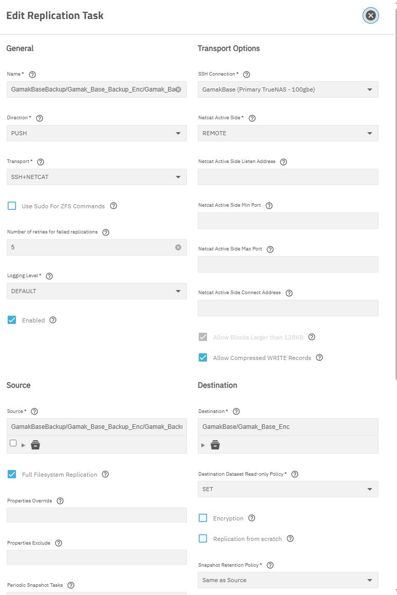

[2025/05/21 07:59:33] ERROR    [replication_task__task_2] [zettarepl.replication.run] For task 'task_2' non-recoverable replication error ReplicationError("Dataset 'GamakBaseBackup/Gamak_Base_Backup_Enc' does not have any matching snapshots to replicate")
Did you do this?
Yes, I deleted it. See below.
Does the Replication Task match the latest snapshot that exists on the source?
This can be by name or schema.
So my snapshots started with “manual” and the replication task was looking for “auto” at the beginning of the name. I think I possibly have this part of accomplished. It appears to have created a new dataset on my primary TrueNAS, so fingers crossed I at least have this one time transfer solved.
After the replication is complete, will the newly created dataset unlock itself? I assume at that point I can download the new encryption key for that data set?
This is why.
TrueNAS does not push ZFS replications with on-demand snapshots. Other tools, such as Syncoid, can do this.
TrueNAS expects there to be a related Periodic Snapshot Task to tether the replications, or at least a naming schema that zettarepl can parse through to know what to send.
