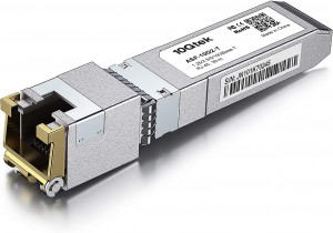

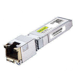

An example from 10GTek

There are newer transceivers (Broadcom) for 10Gbase-t (using one in my not so expensive Fiberstore S3900 (<$300) that uses less power than the old ones and thus less heat.

I am using 10gtek (they have some old ones too that do not use Broadcom), works for me. Yes, my Fiberstore does not seem to have any decent heatsinking near as I can tell. However, my adapter stays under 60c even with Ambient at 85F and in a rack (lightning fried my AC, hopefully finally fixed today).
