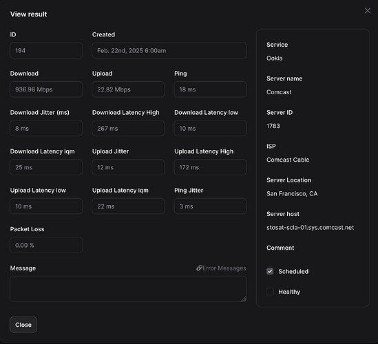

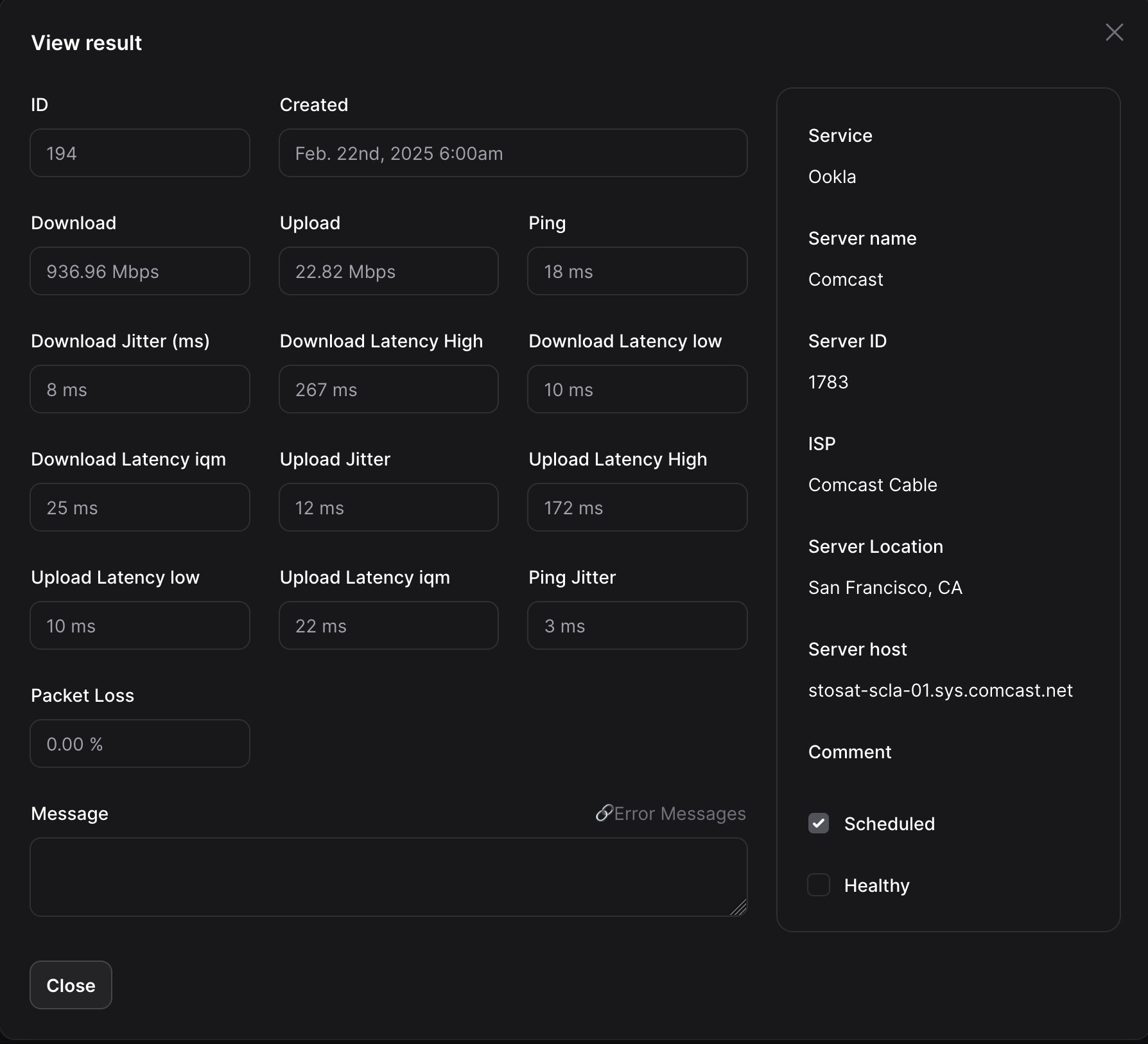

  1. Interestingly… Ookla speedtest using an Ookla server & my truenas build as the client
FYI, outbound traffic is limited to 25 Mbps because of my internet plan
But theoretically, I should be getting speeds faster than 100 Mbps between any computer and my truenas build right?
