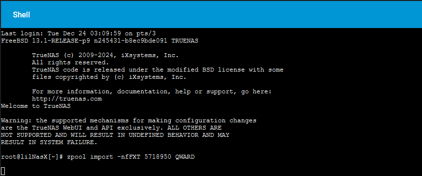

If you do zpool import -f QWARD will the system crash?
If it does, try zpool import -fFn QWARD - the extra capital -F is for a rewinding mount, and the -n is a no-op (to not actually mount it) - what we want out of that is “no output, but also not a crash.”
I booted up to the GUI on my desktop. Then when it was up I plugged in the drive for QWARD.
I tried both of your suggestions and both times it long paused then crashed. It then bootlooped the same way it usually does when I try to boot it up with the drive already connected.

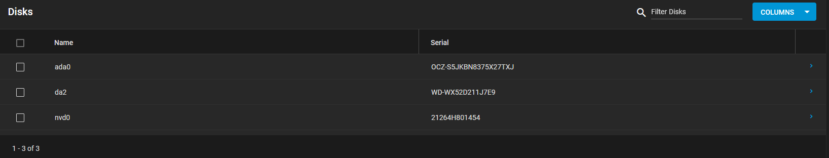

@HoneyBadger @SmallBarky @etorix
I was kind of confused about how the code looks different and also the mention of sdX and I think I know why.
it starts with sudo which seemed familiar because I think that’s Linux
I looked up the sdX thing and it turns out that’s the designation used for drives in TrueNas Scale
Then I remembered a friend of mine told me that TrueNas Scale uses Linux
I am currently using TrueNas Core which, based on my understanding, does not use Linux (at least in the same way) and uses daX (ada, da0, da1 etc) to designate drives.
I was wondering if there is an equivalent to sudo zdb -ul /dev/sda that works with Core?
Yes, you can use zdb -ul /dev/daX here - no sudo needed, as you’re root by default on CORE, and substitute the BSD-style device names of da0 up to daX for your drives.

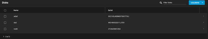

You may need to try zdb -ul /dev/da0p1 or zdb -ul /dev/da0p2 to pick up the actual ZFS partition on the drive. It is able to pick up some uberblocks which is a good sign but it wasn’t able to find the label - that should be resolved by targeting the partition itself.
@HoneyBadger
I tried both and partition 2 worked. What can I do as my next step now?
Just to see, I tried to import the pool again but its still not showing up. I guess most of this will be done via Shell.
So just to confirm, eventually what we want to do is be able to mirror the data on this drive to another one and be able to import this into the QWARD pool?

How long has this drive or pool been offline? The uberblock data from this drive is showing dates of April 22 only.
I think it has been a while due to work and personal responsibilities so I would not be surprised at all at the date.
Do you think it’s salvageable?
Potentially.
Since importing at the one at the top-level (as well as the most-recent three) failed, as implied by the crash from the -fFn then we have a couple options:
Attempt a more extreme rewind with -nfFX to let it push back further.
Specify the transaction group manually with -nfFXT 1234 but instead of 1234 we’ll specify one from your zdb output. If we assume the newest three are hooped (because that’s what -F tries by default, I believe) then instead of 1234 try transaction 5718950 from Mon Apr 22 19:39:55 2024 UTC - so that would be "zpool import -nfFXT 5718950 QWARD - if you don’t get a crash then try it again without the -n in there, but keep all the other letters.
What I find a bit odd is that your label is specifying 5711671 as the entry-point, but that isn’t found in any of your 32 uberblocks listed with the -ul output.
I tried it and it just kind of doesn’t do anything. It just stays on this screen… should I try it without the -n?
It’s going to take a long time for it to think about and attempt the rewind. What you’re hoping for from this command is no output and no crash.
If you get that, then attempt the import without the -n - and when that completes, do a zpool status
