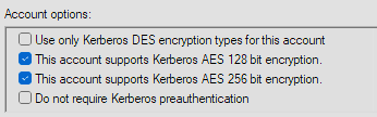

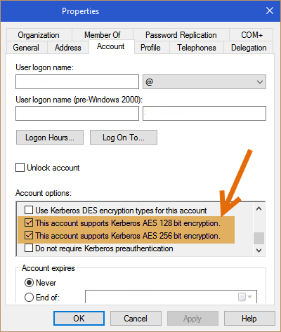

Is the TrueNAS account enabled for AES in Active Directory?
Yes it is, thanks for pointing that out cause it would be easy to miss.
Follow up with a couple more config items that would need to be set in AD, in case anyone else might know of something that I missed.

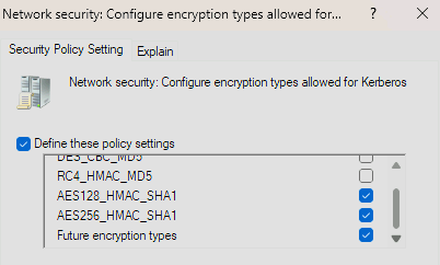

DC are set to 0x18 which allows AES 128 and 256:
and Network security is set:
The only other thing I can think of is that after setting AES on the account the password needs to be changed to generate an AES key, but if AES was the default then I wouldn’t expect to need to do this twice.
