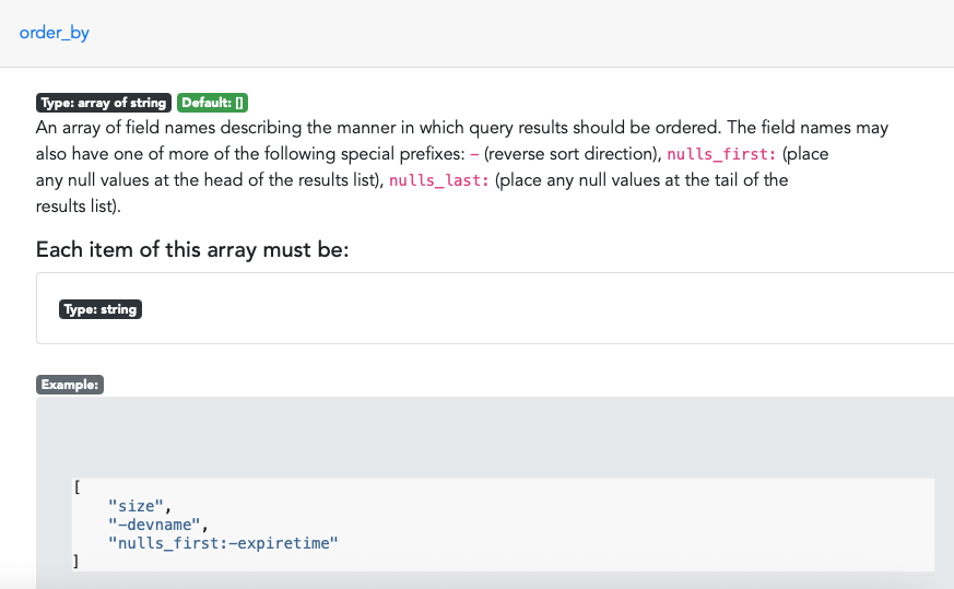

All query methods take the same arguments. The general method to query is covered in the Query Methods section in the Table of Contents.
From the standpoint of the shell middleware client (midclt) they take two positional arguments: (1) array of filters to apply to the query and (2) a JSON object specifying the query-options.
midclt call certificate.query '[]' '{"order_by": ["cert_name"]}' for example.

If you look at the documentation for certificate query:
https://api.truenas.com/v25.10.0/api_methods_certificate.query.html
you can see the entry fields in the “Return value” section. These are the valid choices for order_by and select query-options. They are also the field names that can be used for query-filters.
