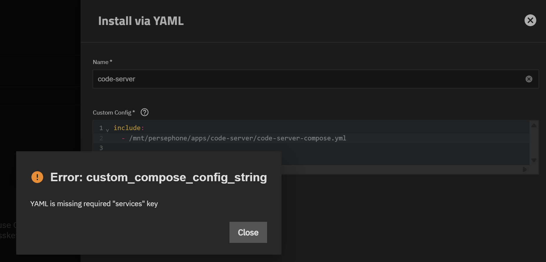

25.10 RC1 Custom App YAML Input Bug?
So today I completed a fresh install of 25.10 RC1. I found that when inputting the following…
include:
  - /path/to/compose/file/compose.yml
…into the custom app option via YAML it gives the error: “Error: custom_compose_config_string YAML is missing required “services” key”
Here is the referenced compose file:
services:
  code-server:
    image: lscr.io/linuxserver/code-server:latest
    container_name: code-server
    labels:
      - "com.centurylinklabs.watchtower.enable=true"
    volumes:
      - /mnt/Hermes/Docker/Data/Code-Server/config:/config
      - /mnt/Hermes/Docker/Data:/data
    ports:
      - 9000:8443
    environment:
      PUID: "568"
      PGID: "568"
      TZ: "REDACTED/REDACTED"
    deploy:
      resources:
        limits:
          memory: 1G
    restart: unless-stopped
In all previous versions where we have had the ability to input custom apps via YAML this has worked to simply pull the compose.yml from a single directory with all of my compose files and create/start the container. Now on 25.10 RC1 it is giving me the error I mentioned above.
I’m not bashing IX, I absolutely love TrueNAS, but I have always disliked the apps creation tool because it lacks repeatability and proper versioning of apps. Using the YAML include: string has been a god send for me and allowed me to deploy apps quickly and repeatably without pain-stakingly configuring it through the app creation ui manually every time I want to spin up the app.
Does anyone else run apps/containers this way and is this issue also affecting you?

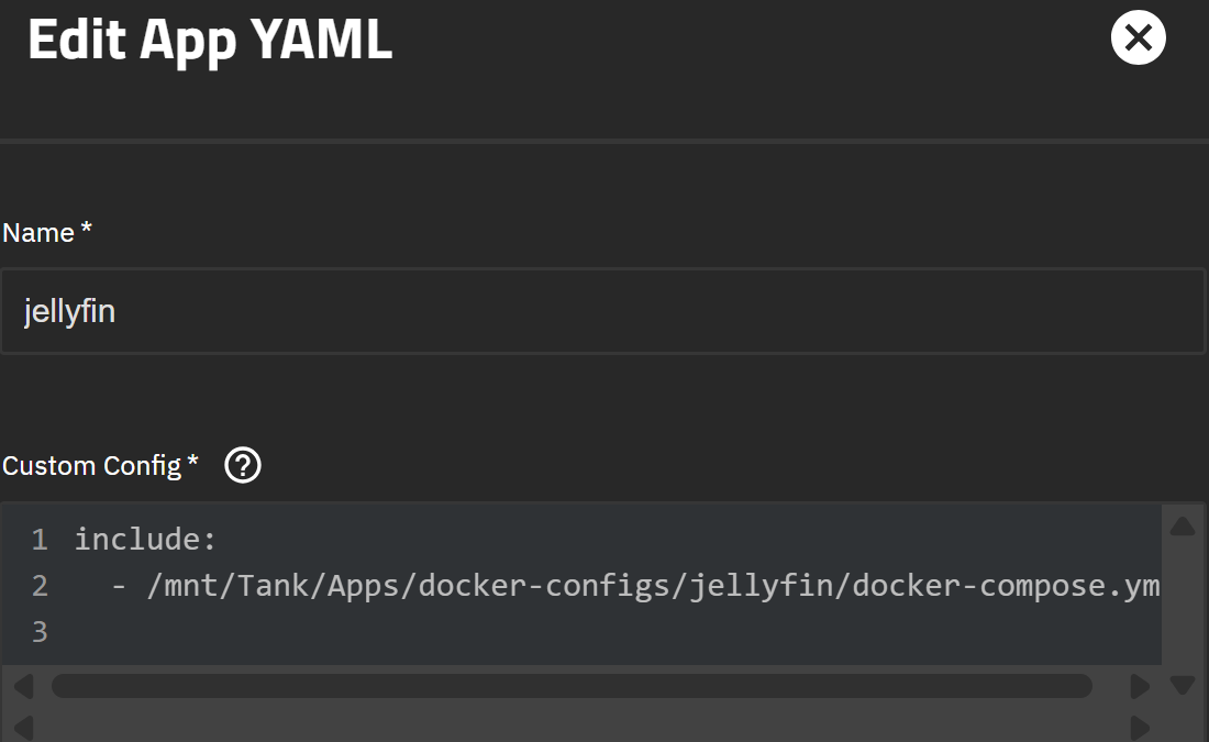

Does anyone else run apps/containers this way, and is this issue also affecting you?
Yep, I run mine the same way. All of my apps live as individual Docker Compose files inside /mnt/vega/docker/stacks, and I’ve been using an include: reference in the Custom App YAML to pull them in. That’s how I’ve managed everything for the last few TrueNAS versions — it kept deployment fast, version-controlled, and consistent with what I do in VS Code.
Since upgrading to 25.10-RC1 (Goldeye), I’m seeing the same error:
YAML is missing required "services" key
Existing apps continue running fine, but any new Custom Apps using the include: syntax now fail validation. Hopefully, iX will relax the schema again or add support for includes, as this workflow has been a huge quality-of-life boost for people running modular Compose setups.
