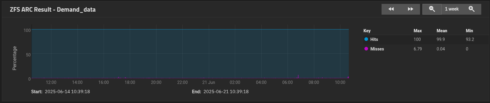

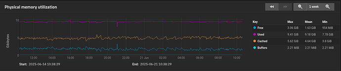

I’m not confident I understand; please can you tell me if am I looking in the right place?
This is what I see on the dashboard of ElectricEel-24.10.2.2
and drilling in shows me
1 week of RAM use:
1 week of ZFS ARC demand use:
This is my array:
Data Topology: 1 x RAIDZ2 | 4 wide | 931.51 GiB
Usable Capacity: 1.7 TiB
and I have no more memory space nor any additional slots and I am happy with the way it works (but I am interested to learn more).
Thanks!
Not any more; iX took this out for some reason. You need to install Netdata or use the arc_summary script to get this information.

You are averaging a 99.9% hit rate on cache. That is pretty good - it means that only 1 in 1000 reads actually need to be fetched from disk, with the remaining 999 being served immediately from memory (the ARC) without any wait.
Great! Thanks for confirming and explaining.
