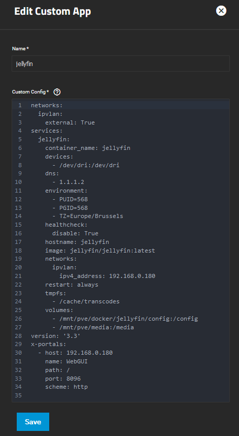

Hi, it’s very easy. Just create the JellyFin app via basic YAML as a custom app like this:
services:
  jellyfin:
    environment:
      TZ: TIMEZONE
    healthcheck:
      disable: True
    image: jellyfin/jellyfin:latest
    restart: always
    volumes:
      - HOSTPATH/cache:/cache
      - HOSTPATH/config:/config
      - HOSTPATH/media:/media
x-portals:
  - host: HOSTIP
    path: /
    port: 8096
    scheme: http

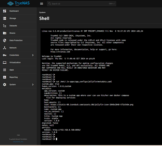

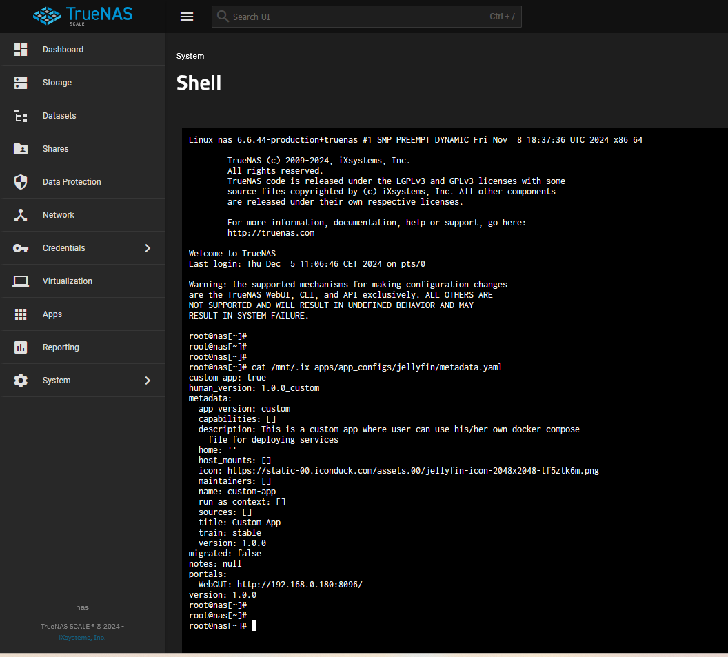

After creating the app edit the /mnt/.ix-apps/app_configs/jellyfin/metadata.yaml file in the Truenas Shell (File is not shared) and add the icon line like this:
custom_app: true
human_version: 1.0.0_custom
metadata:
  app_version: custom
  capabilities: []
  description: This is a custom app where user can use his/her own docker compose
    file for deploying services
  home: ''
  host_mounts: []
  icon: https://static-00.iconduck.com/assets.00/jellyfin-icon-2048x2048-tf5ztk6m.png
  maintainers: []
  run_as_context: []
  sources: []
  title: Custom App
  train: stable
  version: 1.0.0
migrated: false
notes: null
portals:
  Jellyfin: http://HOSTIP:8096/
version: 1.0.0
Just replace TIMEZONE, HOSTPATH and HOSTIP for your country and system. After that save the app in the UI again and the icon should show up.

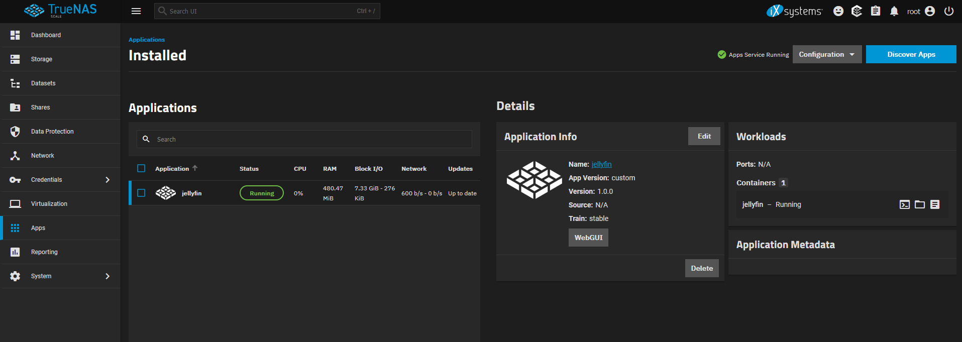

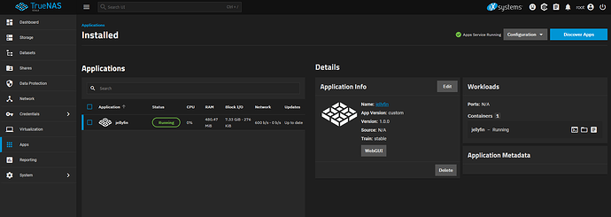

Hello, thank you for your response. I did as you explained and it is OK for the web portal. But the icon does not appear unfortunately. I have rebooted container and PC but without success.

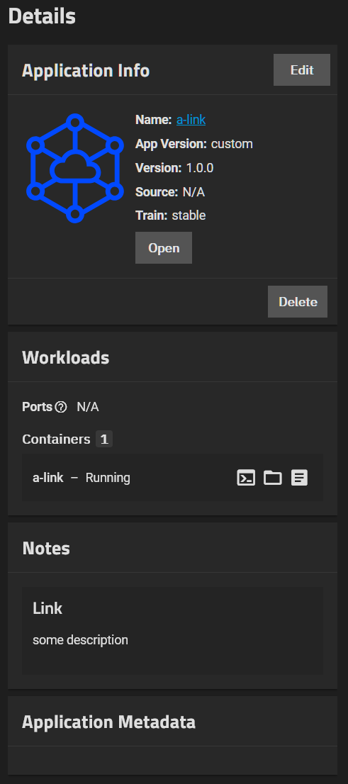

I started with the following test app, hoping it will show up in the UI:
services:
  a-link:
    healthcheck:
      disable: True
    image: tianon/sleeping-beauty
    restart: unless-stopped
x-portals:
  - name: Open
    host: example.com
   #port: <optional port #>
    path: /
    schema: https
x-metadata:
  icon: https://media.sys.truenas.net/apps/storj/icons/icon.svg
x-notes: &|
  # Link
  some description
This didn’t show up. I then manually entered into /mnt/.ix-apps/metadata.yaml the missing entries (making sure to remove the x- prefix), refreshed and got the UI I was expecting.
