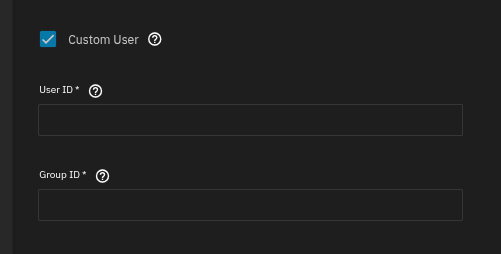

Can you change the Czkawka app to run under the UID 3000? For some reason, SCALE’s first created user defaults to 3000, rather than 1000, as most other systems do.
Thanks. How would I go about doing that though? Is this (see below) what you have in mind?
And what would the Group ID be?
Not familiar with how SCALE handles that with its Apps, but that looks like where you would configure it.
Perhaps both set to 3000.
Thanks. It turns out that the user in Czkawka is handled by means of environment variables, so I made the requisite changes in the container config:

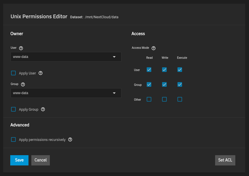

Lemme guess: go to “Datasets,” select the dataset in question, go to “Permissions,” click on “Edit,” and make the requisite changes, right? Would that, however, (1) add a new ACL, or would it (2) change the existing www-data ACL (which is something I do not want to do!)?
It depends. What are you looking at? Do you see a page that allows you to add more ACL entries? Or does it look like a page to change basic Unix permissions?
The latter.

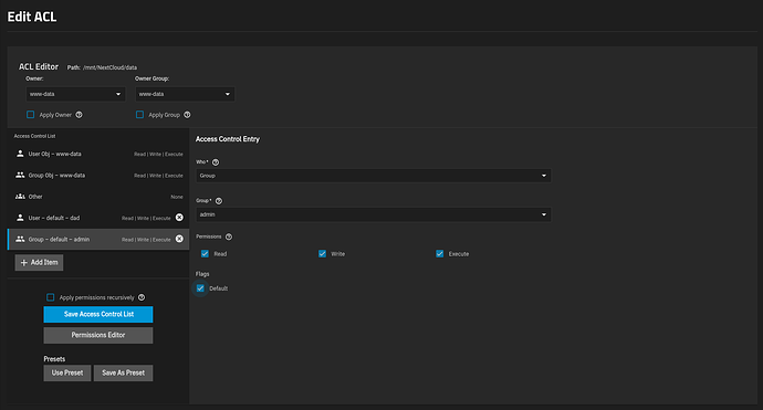

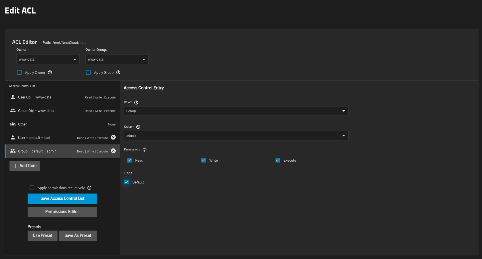

Here’s where I got so far (and the official instructions are not very helpful unfortunately):
As you can see, I added a couple of new entries for user dad and for the admin group. Not sure if they are both needed, or just admin would suffice (note that dad is a member of admin). Anyway, one question is, would I have to change the “Owner” and “Owner Group” as well (under the “ACL Editor” heading above)? As far as I am concerned, this dataset can keep its owner, as I want to be as non-intrusive as possible.
Also, should I select Apply permissions recursively? What does it even mean to have certain permissions for the dataset that do not apply to all its folders inside? :thinking:
Probably. Otherwise the files and folders will not have the needed write permissions. Is it a large dataset with many files?

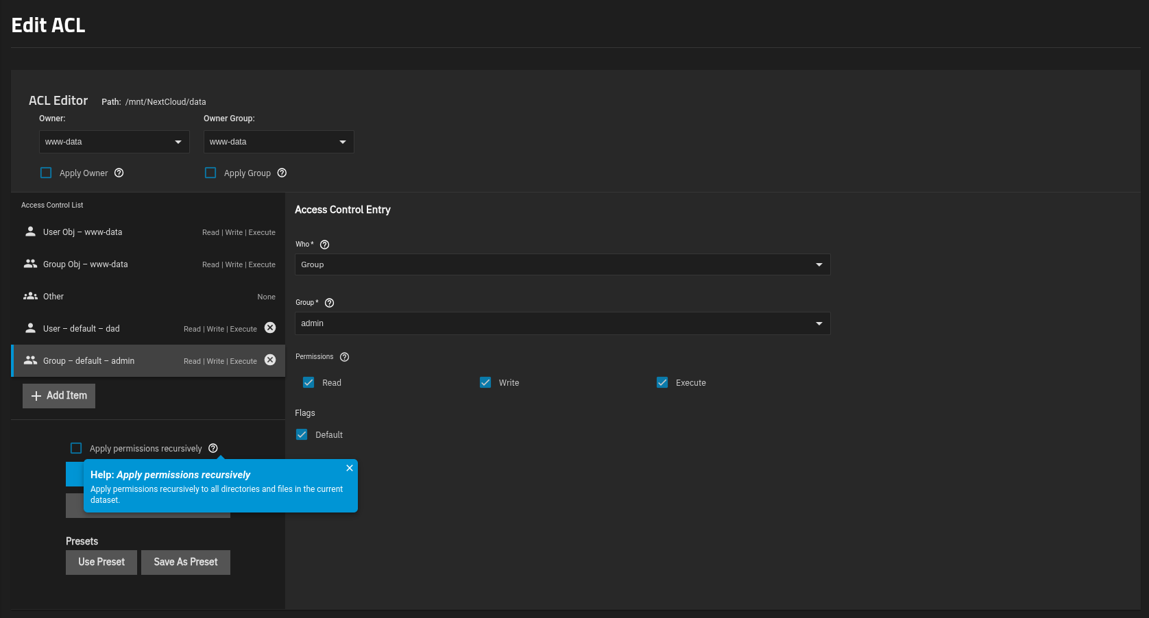

Here’s what the official instructions say about “Apply permissions recursively”: (Optional) Select Apply permissions recursively, below the list of access control entries, to apply this preset to all child **datasets**[!].
Note that there they speak about child datasets(!), not about “directories and files in the current dataset” (see screenshot below)! So which is it? I myself am inclined to believe the former.
Anyway, it’s a mess, and thanks for sticking w/me!
The official Docs have always been all over the place. This wouldn’t be the first time. :sweat_smile:
Applying permissions recursively should stay within the dataset. The tooltip says as much.

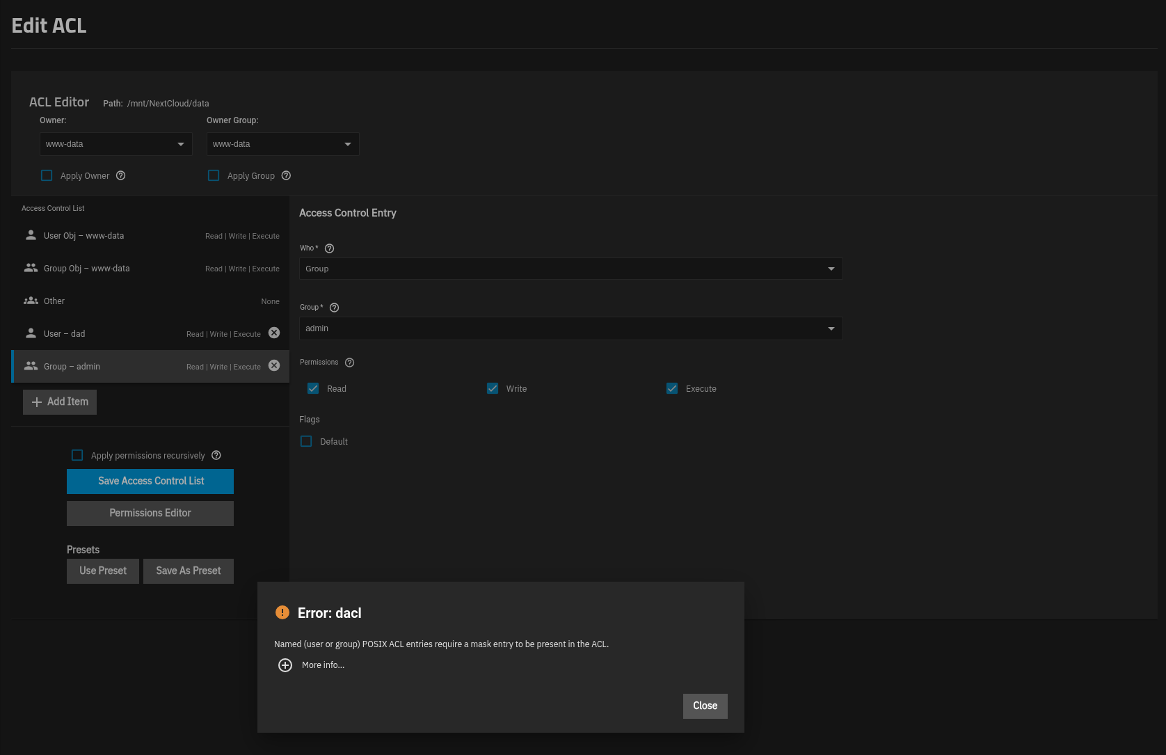

Anyway, I tried to apply the settings illustrated in the screenshot below, and I got an error like this: Named (user or group) POSIX ACL entries require a mask entry to be present in the ACL.
What fresh hell is this now? What “mask entry” would that be?
There’s no option to use NFSv4-style ACL?
NFSv4 ACLs are simpler in general. If you click dropdown for entry type there’s a mask entry. If you’re planning to use POSIX1E you’ll need to define both ACCESS (non-default) and DEFAULT entries for UGO + MASK + any other groups.
