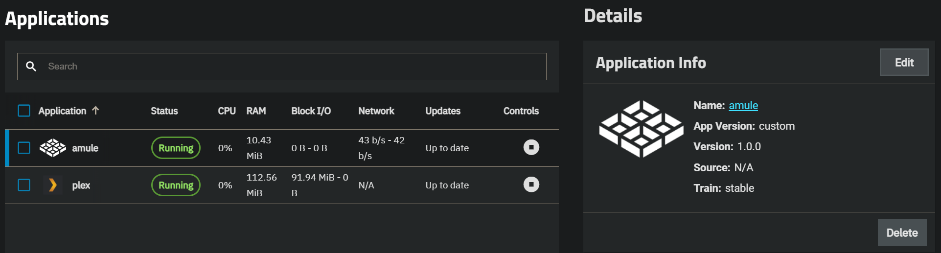

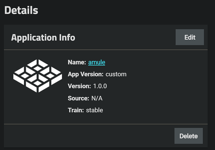

Where is the programm installed into? If I browse to /mnt/Apps/aMule/ is emplty.
How do I login into the control panle, I’ve tryed all the passwords, also admin which should be the right one, but nothing
in the application info there’s no webUI button
All the IP adress are 0.0.0.0 and I don’t know what to do
Thanks

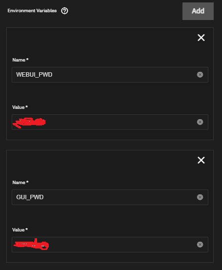

About login into the control panel, try to add environments variables WEBUI_PWD and GUI_PWD and set any text as user and pass
And of course add the port redirects
