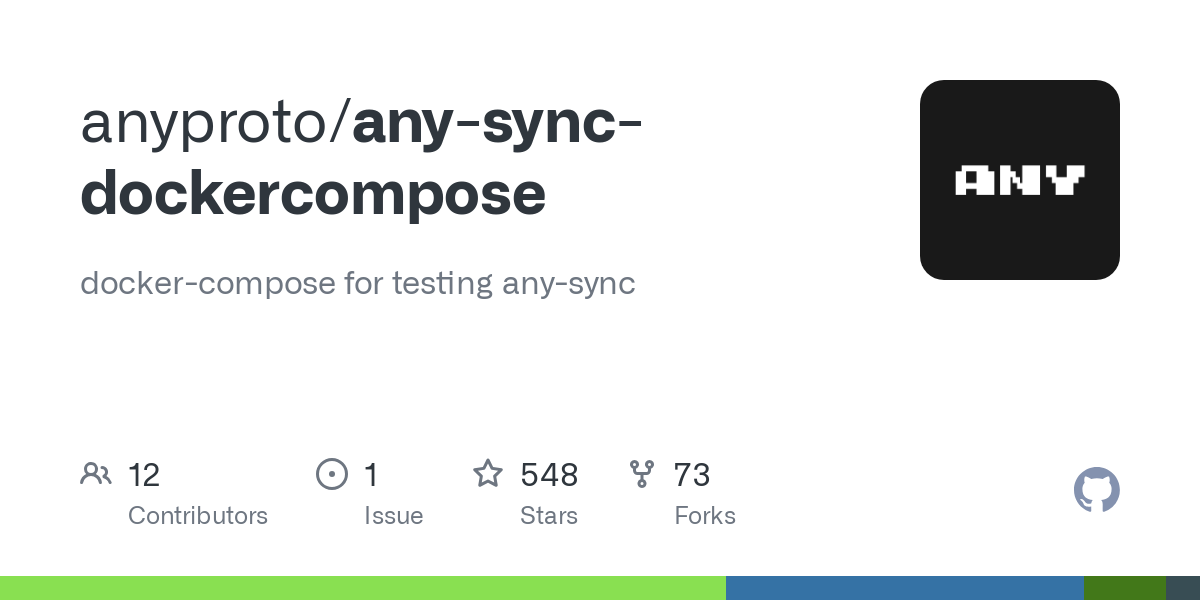

You can run it selfhosted under docker:
Then you can run it under TrueNAS.

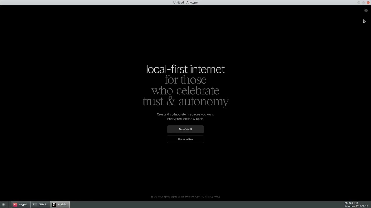

Set up a VM with debian and installed anytype using the following installation-guide:
It’s working now on my Truenas selfhosted.
