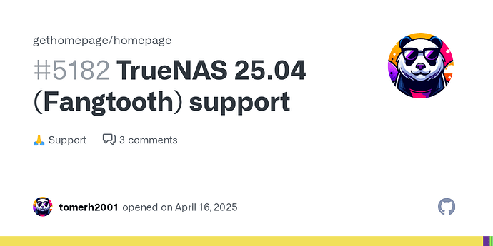

Found it
Seems it wasn’t an error with the homepage widget, but with the truenas api.
There should be a fix comming with 25.04.2
