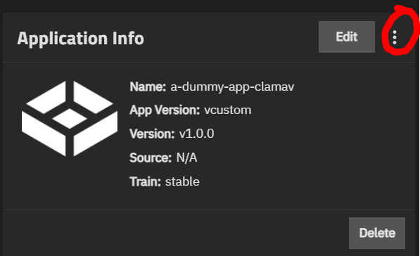

How did you get this from the app? Looking around I do not see anything
Sorry - I don’t understand

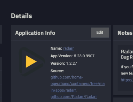

Does this help
Yeah I JUST made that feature request today. I looked and did not see one, so I made one.
They added it right after you requested it.
Thanks!
I do not have the three dots like you do
I am sorry? They added what?
It’s useful to list which version of TN you are using, since different versions are typically different.
Sorry, I am using the newest version. I did tag Scale in the post so I did not mention it was Scale.
Please be specific., what version number?
It’s visible on the first page/dashboard.
ElectricEel-24.10.2.1
Thank you, I’m glad I asked.
The latest (stable) version is Fangtooth 25.04.0, released 3 weeks ago.
It’s likely that this explains the discrepancy in the UI, albeit I am not in a position to test it.
Updating ought to be a fairly painless procedure if you don’t use Virtual Machines and if you feel comfortable updating to a .0 release.
If you are using VMs you may want to wait a bit as the VM functionality in Fangtooth is undergoing changes and is currently marked experimental.
You update by going to System Settings → Update and selecting the Fangtooth train.
I will try that. I do have a VM but it’s literally just created and not really needed.
