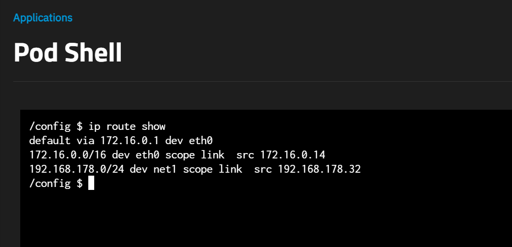

The default route in any app/custom app Ive tried is pinned to the 172. interface, and not the external interfaces added to the app through the web gui. It is forced to NAT from that to the NAS interface.

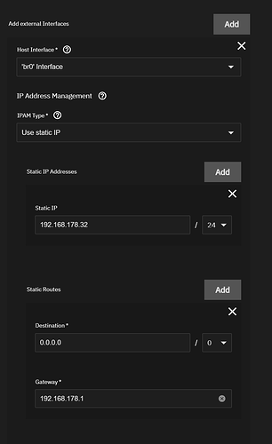

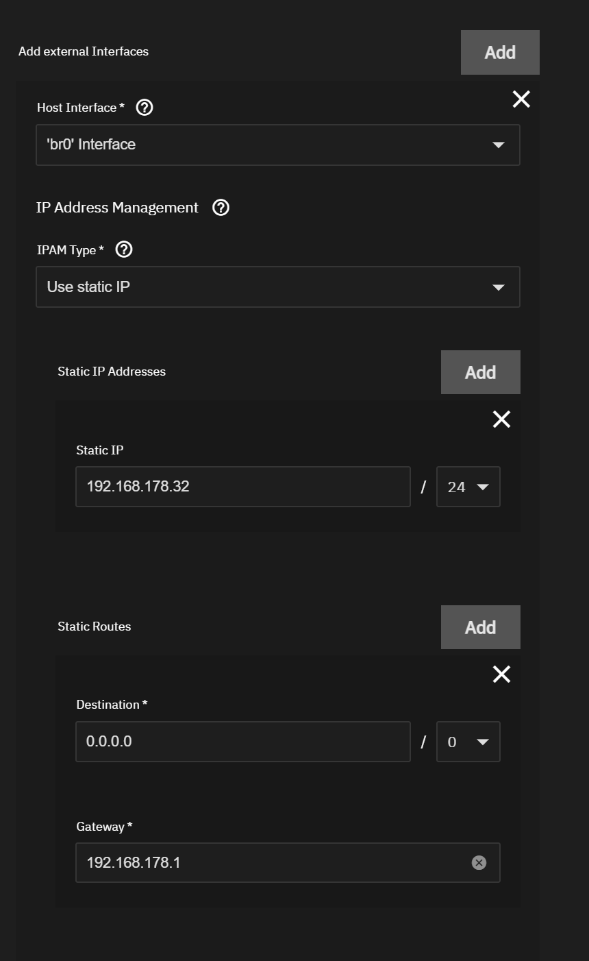

You are missing something then. If you have a bridge interface, then in the custom app, you can set your ip to anything you want, static, and, set the default route to your router, whatever. I have a number of static ips via custom apps. Even DLNA works then, as otherwise it’s pinned to the private network.
To be clear - not speaking of exposing anything on 172. network. Here is an example from my custom app for caddy:

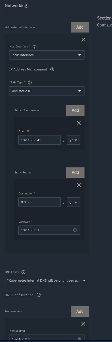

Strange I have a similar config, yet ip route show in the pod shows 172 interface as the default. Is your 192.168.3.x subnet the same as the TrueNAS management interface? The external interface and TrueNAS interface are the same subnet on mine, I’m wondering if maybe that has something to do with it?

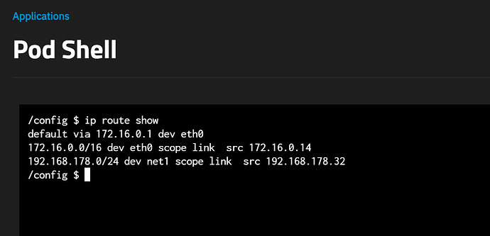

Yours is fine. Default network for you is 172.16.0.1 but anything destined for 192.168.178.0/24 routes directly via 192.168.178.32. What’s wrong with that? You’ll always have both networks, as one can reference other containers from within a container and that will use the default route in that case and not NAT it. A perfect example of that is again my caddy. Caddy (reverse proxy) talks to the other containers via the kubernetes private lan as it’s less efficient to route otherwise. Those other containers are references via their kubernetes dns names.
I cannot see the real source of the traffic on my firewall destined for www - it’s all coming from the NAS interface.
Which means that my policy based routing on the firewall doesn’t work, eg I have rules if source is 192.168.178.32 use WAN Gateway 2 (my firewall has two WAN connections).
Each app has its own interface and IP, that part works fine, I just desperately wish 0.0.0.0/0 was on net1 not eth0.

Strange, my traffic comes from the static ip in all tools, even dlna. You must have another setting somewhere off. I guess go with your simple solution for now, save time, and re-visit when Eel comes out. Docker does create it’s own network also, though, it remains to be seen how it is implemented in Eel. I’m going to be running the Eel Beta once the code is checked in for Docker stuff and hope to test out as many uses as possible. For me, for example, it’s annoying that I have to manually set a static IP today, the mac address changes every time you run the container so hoping for a better experience.
