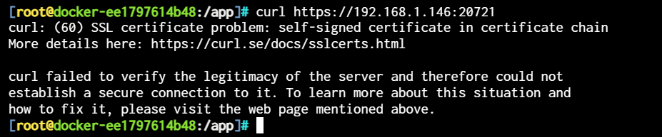

The problem I’m facing is apps cannot reach this local DNS. At first I thought it was unreachable for them, but if I am able to curl the DNS web interface. Can anyone help me understand/fix this?
If the curl failed too, it wouldn’t surprise me. The container doesn’t have a bridge interface, and there is probably no route to the 192.168.x.x network (I guess). But since it works, I’m afraid I might be misunderstanding something.

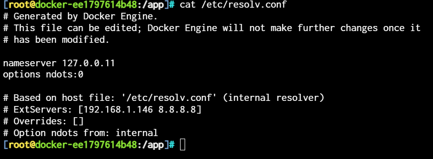

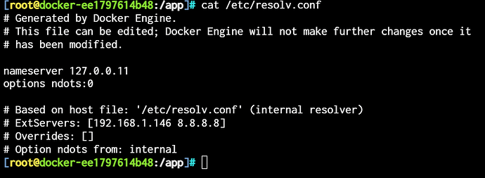

This is from inside the rev-proxy docker:

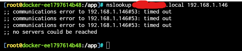

This is what happens if I try to resolve a hostname using the local DNS:

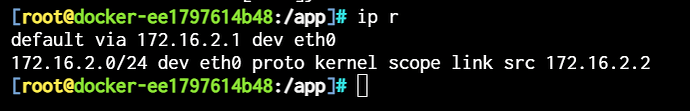

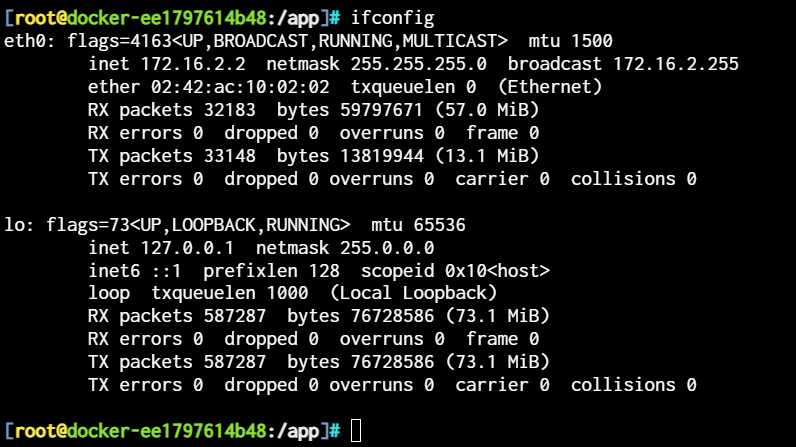

An ifconfig from inside the docker:

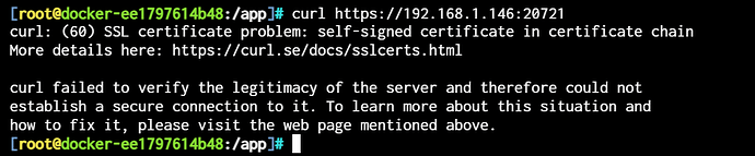

The curl working properly:

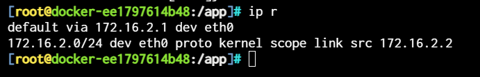

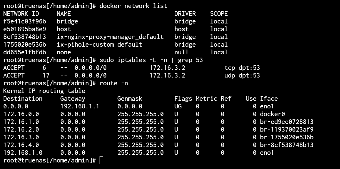

What does ip r say about your routes from within your docker container?

The ip -r command returns this, which means it shouldn’t be able to route to 192.168.1.146 when using curl:

I was also able to narrow down the error:
  • DNS queries from a container fail when using UDP, while TCP queries work fine. The DNS server is the Pihole service exposed through TrueNAS’s IP (192.168.1.146:53).
  • DNS service is listening on both TCP and UDP ports (I am able to query it from TrueNAS shell).
  • TrueNAS network config doesn’t look bad (although I might be missing something here)
I know there must be something related with docker’s networking I must be missing here.
