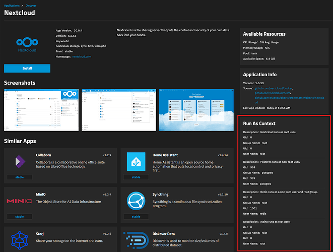

Is there a better way than looking at the app “recipe” on github to find out what e.g. UID and GID of the postgres user need to be?

The UI shows you the UID/GID of the main app container and service, but to my knowledge not of all additional containers which might be different. E.g. postgres.

From various posts after DF to EE migrations who had permission issues with postgres, i remember that the build in apps, that use postgress needed permissions for user 999 for postgres, if this is also true for custom apps i don’t know
Correct. I found out myself by looking up the source on Github. My question is if this information is also somewhere available in the UI when setting up the respectve app.

The Run As Context widget on the app info screen should have all needed IDs.
We’ve talked about getting this information included somewhere on the installer screen as well, but I don’t know what the ETA on that is.

With the "Run As Context you mentioned. Is it recommended to leave that as is? All the users would be created already?
If you use the Enable ACL checkbox when setting up a host path in the app install configuration, you can add an ACL entry for any UID/GID, regardless of whether that account exists on the TrueNAS host. If the app wants 1001:1001 for some container, that user is not built in on TrueNAS, but you can still enter an ACE for 1001 and the container run-as user will have permission to access it.

I just found out about the “Automatic Permissions” checkbox specifically for postgres. Great work!
