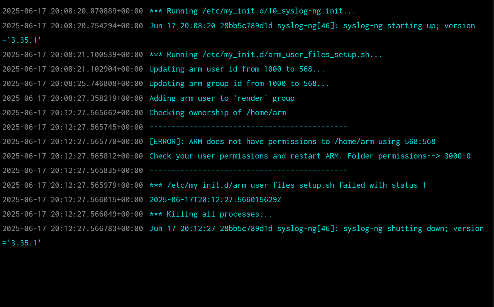

Recently installed my first attempt at TrueNas and things seem to be stable, but odd things happening with Automatic Ripping Machine… Needed to add a PCIe card so my DVD/BR drives were on separate SATA controller, and was finally able to rip a couple of discs though TrueNas only reported the app as “deploying” (though the web UI was available and successfully ripped disks from both drives)
Fast forward a couple of days and a couple of reboots, and now the ARM app crashes on startup with the following log:

However, after attempting to restart the ARM app, TrueNas still shows only “deploying” but the web UI is available, and it has started ripping a new disk…

Is there anything I need to do so that ARM will start successfully the first time?
Is there anything I need to do so that TrueNas sees the ARM app as fully running?
