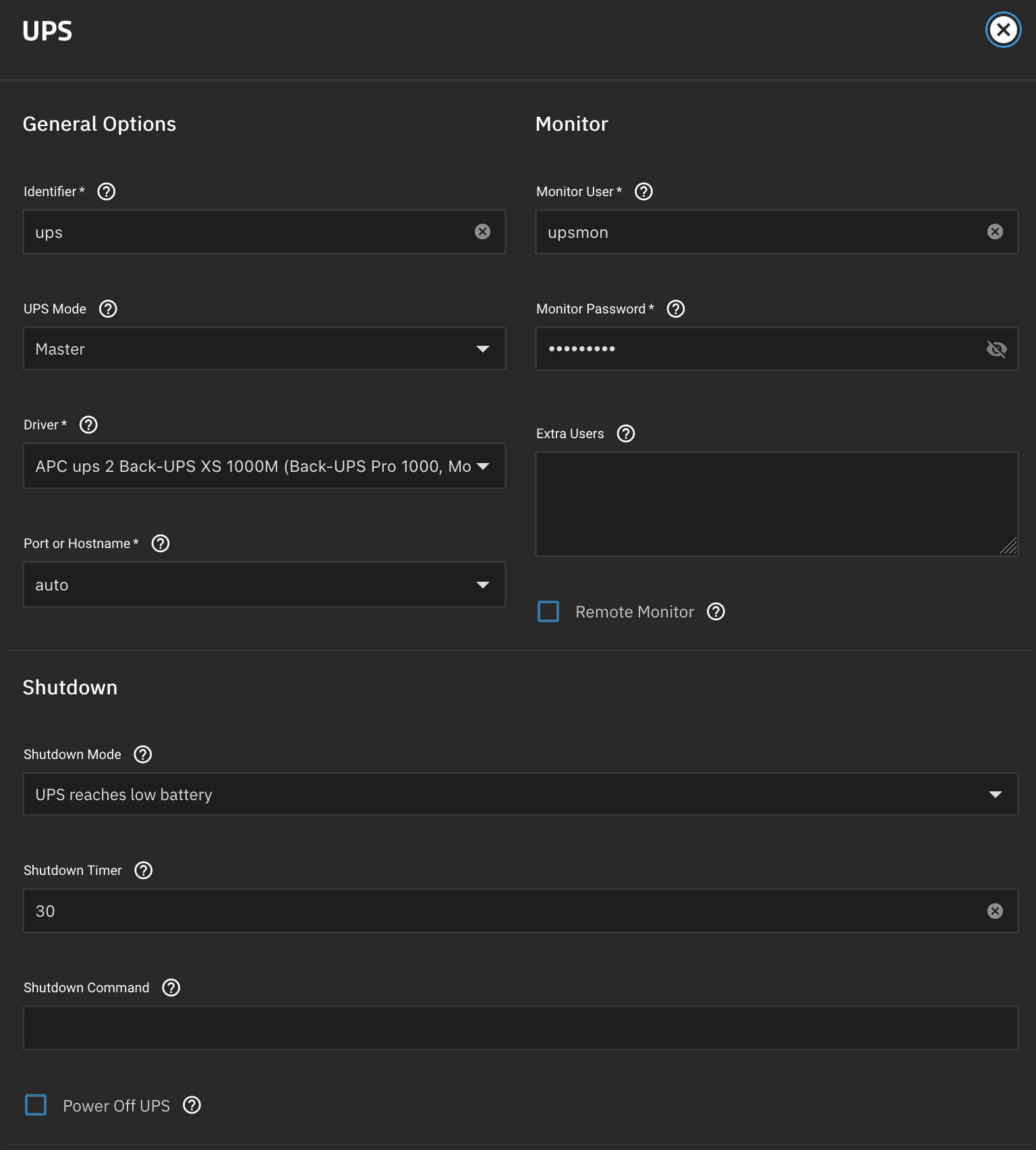

Here’s a screenshot of my config:
Any advice would be appreciated.

As an interim measure (as mentioned above), I set the pollonly parameter which suppressed these alerts. It looks like this in the config:
