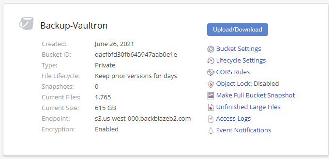

Just as a guess - are there snapshots and are they being backed up as well?
Or even is B2 making and keeping snapshots?

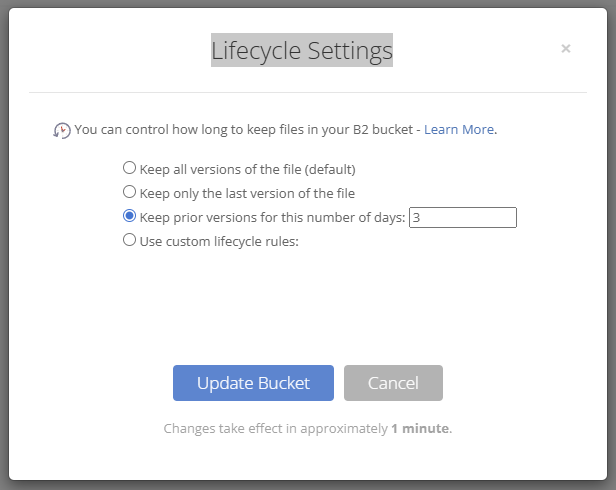

Check your bucket settings on Backblaze:
Maybe it’s your Lifecycle Settings:
My guess is that the Lifecycle settings is keeping all the versions of the file, and isn’t purging out the old versions.
I think this was it! Thanks so much, I didn’t realize there were options like that on the backblaze side.

Just give it 24 hours for the changes to take effect.
