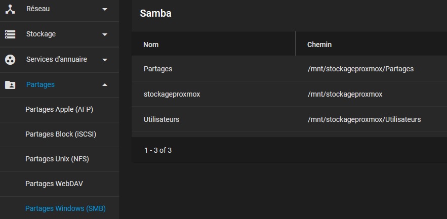

backup_dir=“/TRUENAS/mnt/Partages

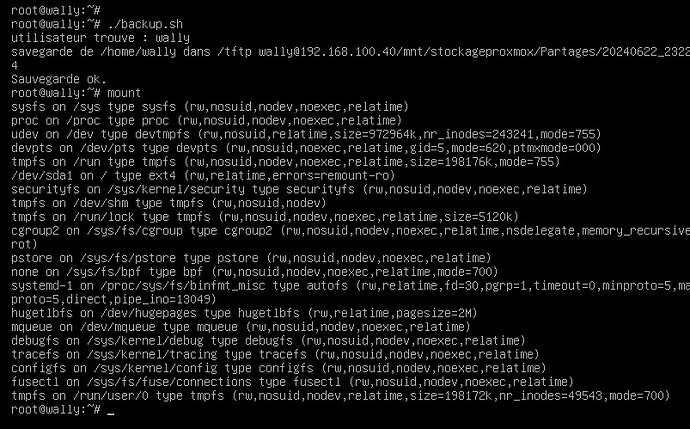

Where did you mount that share in your Linux machine? I.e. what is the output of mount in a shell on that Linux client?

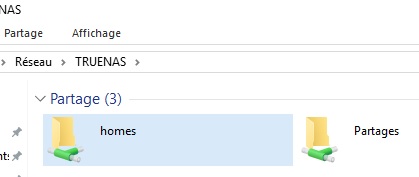

I show you this screen shot in order to explain that I can connect to this share folder on win10 but not with the bash script. i’ve been trying this issu for a week.

Where did you mount it? You said you had already done the mount? So where is it mounted?
sudo mount -t cifs ... something something - you did that, right?
Again: please post the output of the mount command on your Linux client.
Not on TrueNAS. You said you had mounted the share on your Linux desktop. That is what you must do. For how to do that refer to the documentation of your Linux distribution or the hints on “mounting” that I linked above.

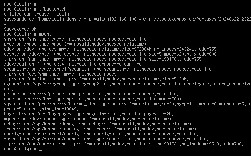

You still owe me the output of the mount command on your Linux client ![]()
On your Linux client in a shell type
M O U N T [ENTER]
Copy the output as text here, please.
