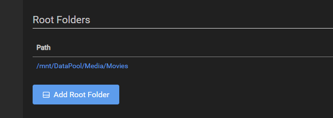

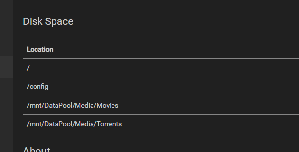

You need to make sure you give permission to all the datasets and the root folder is set correctly. For Example, these are the datasets my Radarr can see
For example on my Radarr, go to Settings > Media Management > Root Folders - add it here
Do the same on Sonarr with the correct path for that.

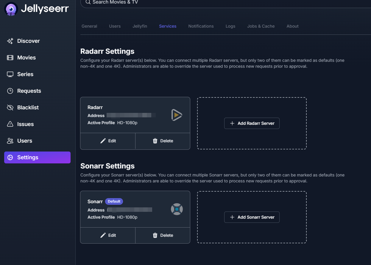

Jellyseer is connected via API again
Then you just set in Sonarr/Radarr how you want the files to move/rename. Make sure it can see wherever you are setting your torrents to go to though.
