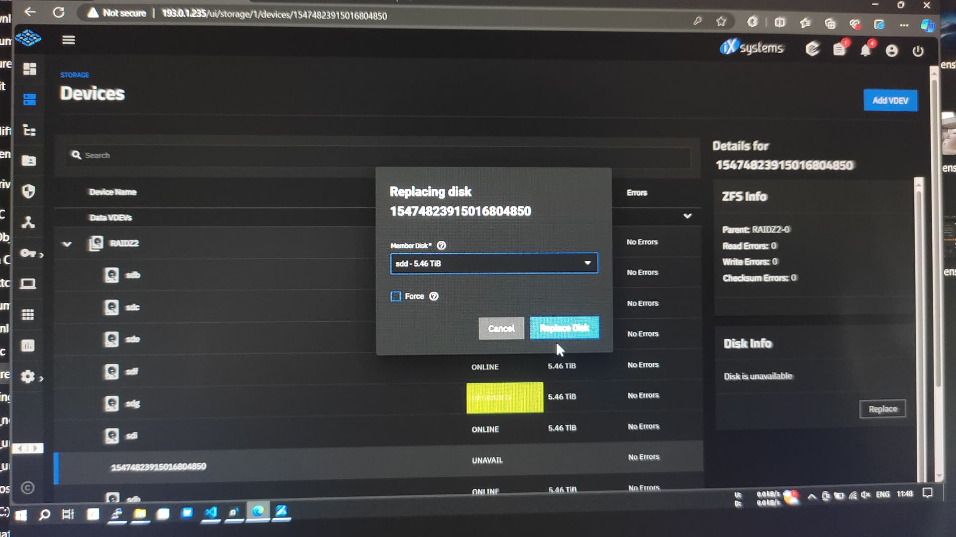

A few days ago I had a problem on the TN server. There is 1 disk that is degraded and 1 disk is in the process of being replaced.When the process took a long time, I tried to monitor the resilvering progress but couldn’t. A notification appears if there is an error

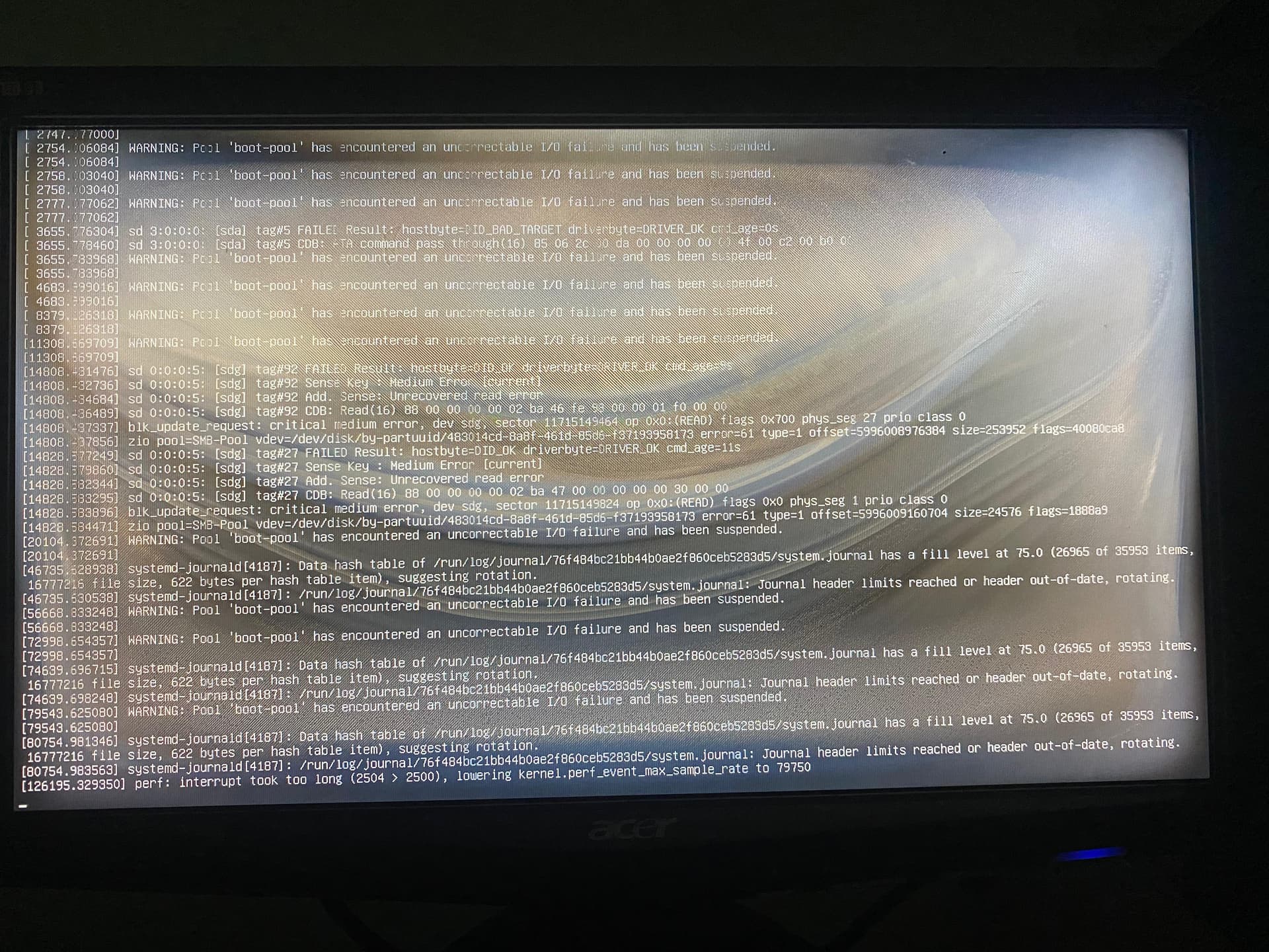

It looks like the server bootpool disk is damaged. My question is, if I replace the bootpool disk and install Truenas OS on zfs /SMB-Pool can all the data be detected again?

Yes. It looks like your boot-pool has failed and you didn’t have it mirrored.
Yes. You can just re-install your boot pool. Probably on a new device.

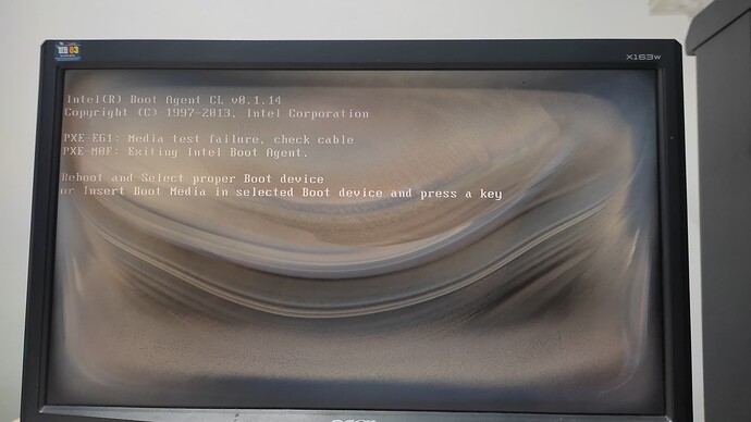

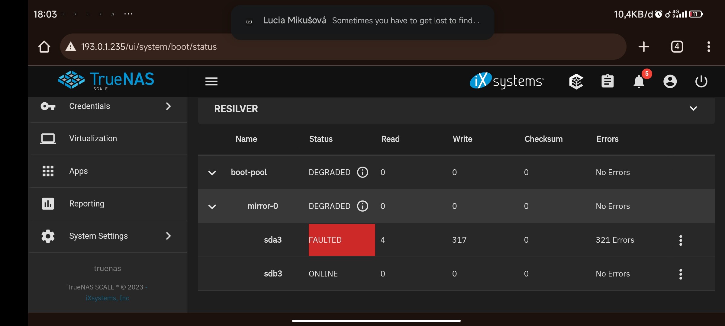

You’re right, the boot pool is failing. I turned off the server and installed a 256GB Sandisk SSD. I made it a bootpool mirror. And this is the result…
Do you have any suggestions for the failed boot pool?
The failed boot pool uses mSata 64GB. Should I replace it with a SanDisk 256GB SSD?
