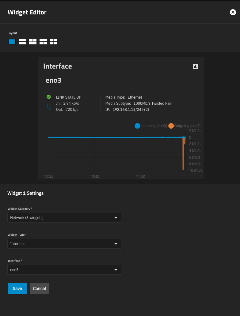

It’s in the GUI as “media subtype”:

Hello, where do you get this panel? I searched for a while (25.10), can’t find it.
It’s a widget you can add to the dashboard, like this:
Thanks, it works. It’s quite strange, there was already a default nic widget in the default dashboard, but without the “Media subtype“ line! So I deleted it, re-added the network interface widget and now the line is there.
