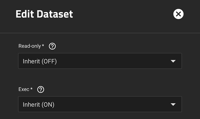

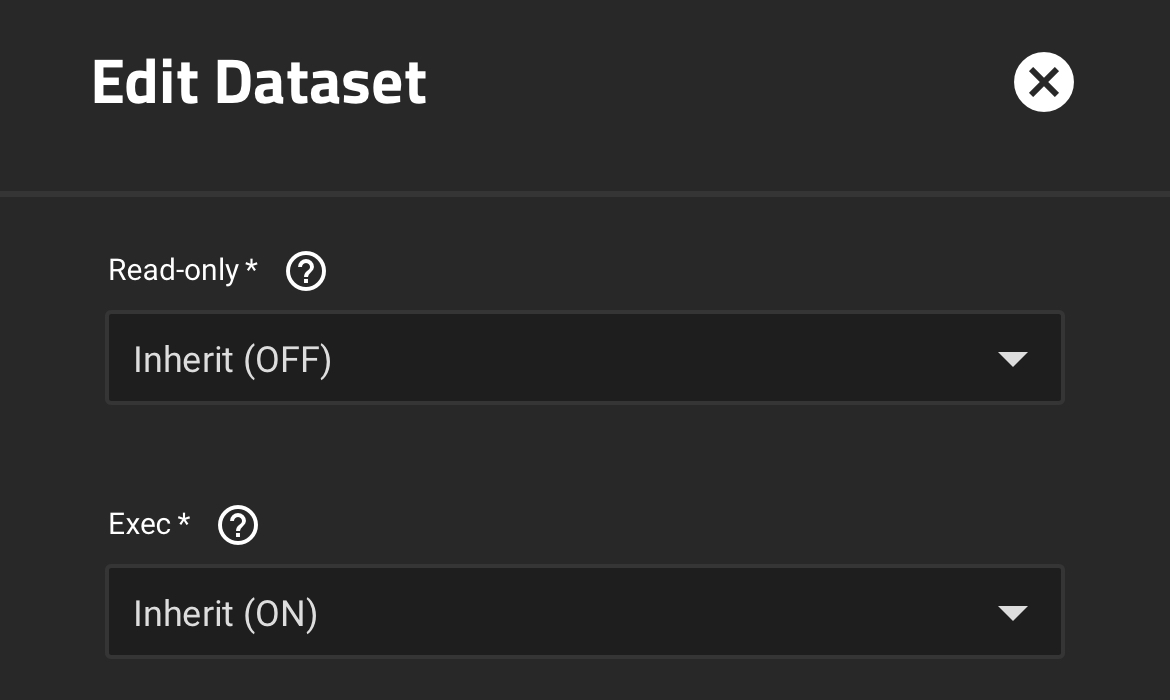

Additionally, datasets have an “exec” property which needs to be enabled for executables to be run.
