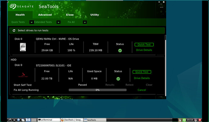

The test I wanted to run is the fix all long which takes almost a week to complete.
Running in an incus VM with the extra sata device PCI-forwarded. I had to forward the entire device so that the PCI reset worked as expected:
00:11.0 Unassigned class [ff00]: Intel Corporation C620 Series Chipset Family MROM 0 (rev 09)
00:11.5 RAID bus controller: Intel Corporation C610/X99 series chipset sSATA Controller [RAID mode] (rev 09)
This is cool. Loving TrueNAS!
