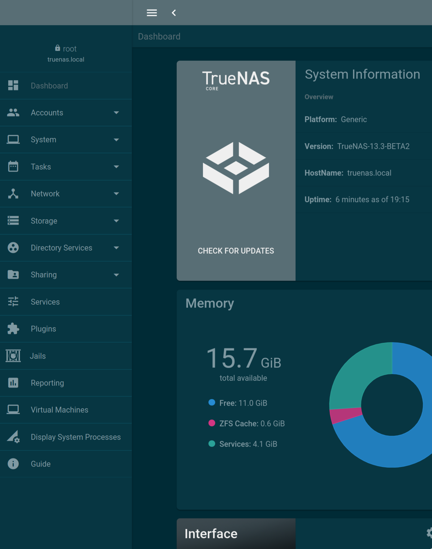

oh my god, I was blind. I’ll update trueNAS now. sorry for my misunderstanding
victor
July 19, 2024, 5:03pm
16
Yeah they have to be done outside the jail. I thought you were trying to reinstall the jellyfin package.
I would update TrueNAS to 13.3 beta, then the jail, then it should just work after that.

yeah my bad, I completely missed the part that I had to upgrade trueNAS itself. I am picking the beta “train” now
