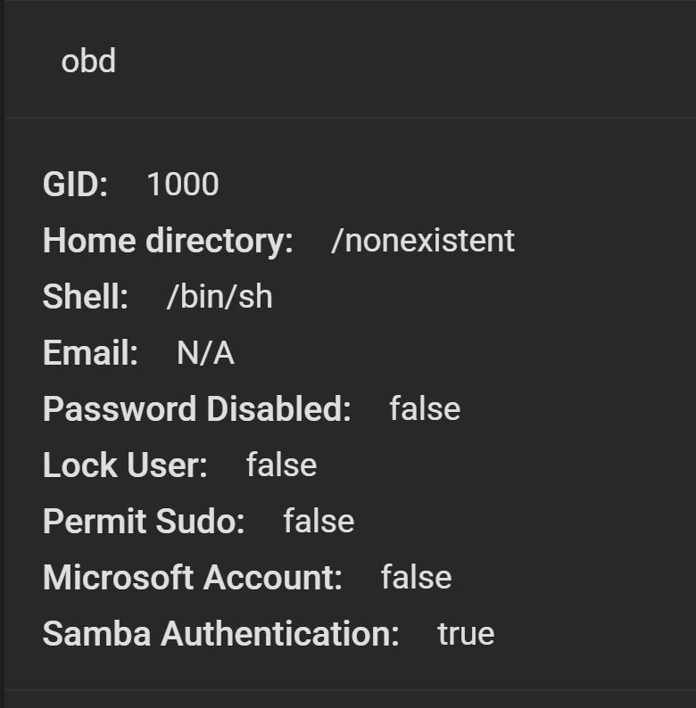

this is user
1000
/nonexistent
/bin/sh
N/A
false
false
false
false
true

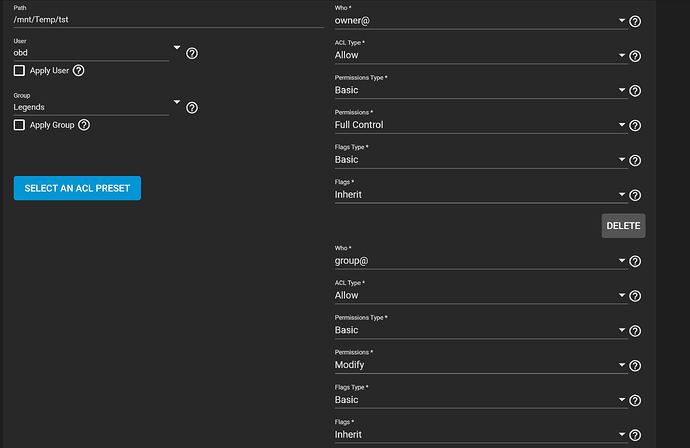

yes the user is the owner
thank you
Inherit (off)

I created new user and new dataset based on YouTube explanation ( [Lawrence Systems] video
And did you edit the Dataset ACL’s so that your new user has permissions to access the Dataset?
So contrary to the video I’m going to suggest leaving ‘User’ and ‘Group’ alone which on CORE I believe is root and wheel but on SCALE is root and root.
I would also remove the owner@ and group@ entries unless you know you need them and then simply add in your user or group with whatever access is desired Modify / Full Control etc.
Finally if you already have data in the dataset then you will need to check the box that says ‘Apply Permissions Recursively’.

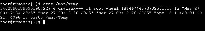

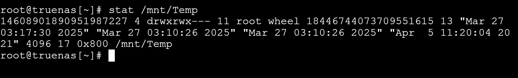

There are some remarkably incompetent howto videos floating around youtube that advise users to chmod 770 /mnt/tank from shell, which of course breaks permissions for everyone. So maybe also post output of stat /mnt/Temp from shell.

There’s your problem. You ran chmod 770 on /mnt/Temp. Incompetent youtube influencers FTW. Run the command chmod 755 /mnt/Temp.
When you remove the other execute bit (like the video you followed suggested for “security reasons”) it prevents all users who aren’t a member of the wheel group from being able to traverse the mountpoint for your pool. It basically breaks everything for non-root users.
