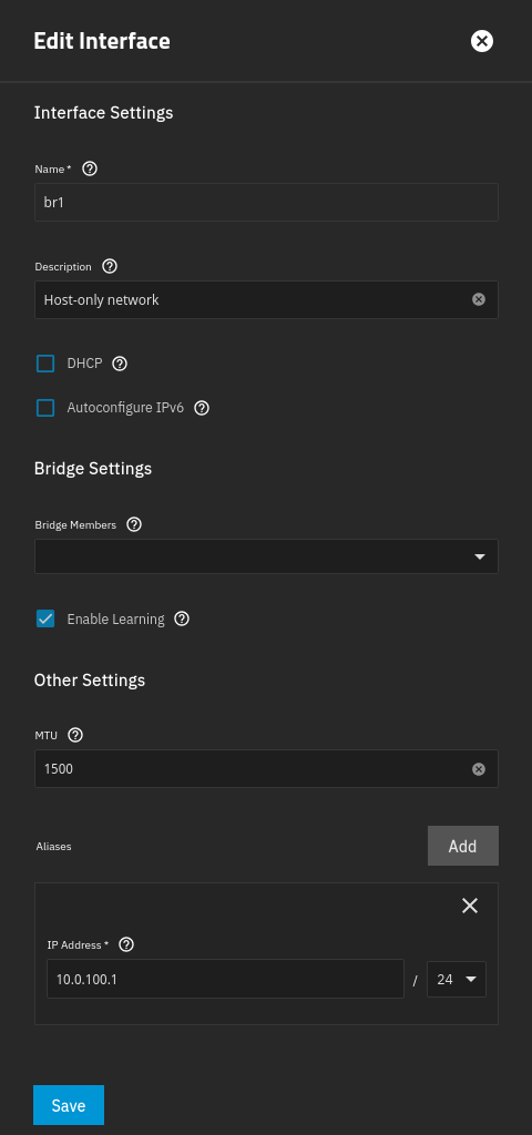

1) Regarding connection between Host and VM
There is a simple solution: create a second bridge interface for “Host-only networking”.
For example:
  • Interface name: br1
  • DHCP: off
  • Bridge Members: Do NOT add anything :wink:
  • Aliases: set a static IP here → this is the IP of the host on that bridge. For example 10.0.100.1
Then attach br1 (in addition to br0) to your VM, and configure a static IP on that adapter. For example 10.0.100.2
Now in the Proxy Manager, use the static IP of the VM you configured (10.0.100.2).
Done.

On my own server I created two bridge interfaces to do two different things.
br0 is bridged with a physical interface to provide Internet access to the VM. (same thing as you did)
br1 is a bridge without any physical interfaces, using a private IP address range.
br1 is the one I’m using to access the VM from TrueNAS, and vica versa. This is very simple, and uses static IPs, I think this must work because it eliminates everything outside the server.

I tried your trick with the br1, I added a second NIC to my VM with br1. I tried both VirtIO and direct network card but none works. I try to find if thhe VM got a second IP in the 10.0.100.x range, (assuming the Ip from your example), but I don’t see anything like this when doing ip a form the VM.
