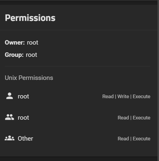

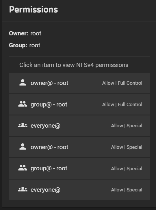

ok, so i did that and the result is attached, along with what the other vdevs look like permission wise. any way to get back to that?
thanks for any guidance.
It appears you had previously applied an NFSv4 ACL to the pool’s root dataset path.
You will need to strip its ACL.
